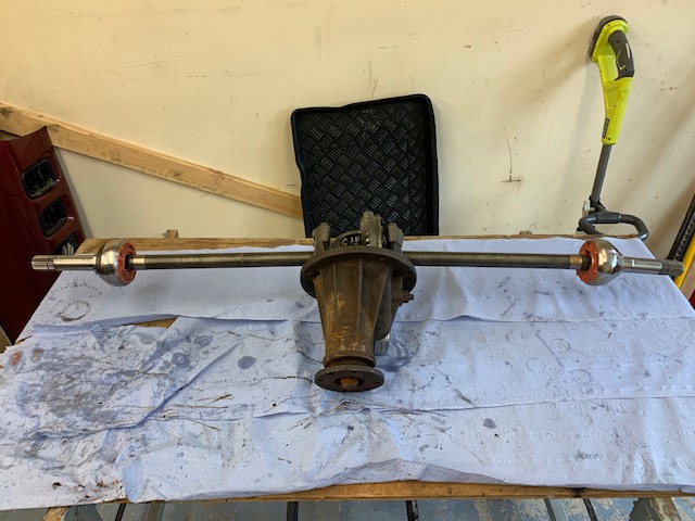

Stripped and rebuilt the rear (front) diff to convert it from 22 spline to 26 spline to suit the TG HD shafts -
And then cleaned the axle up ready for cutting soon -

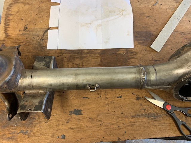

So the axle tube needs 13" / 33cm cut out here'ish -

There's lots more photos and blurb in the blog - lilbugga.wordpress.com/2021/10/24/narrowing-the-rear-axle/ - and on facebook too, but here's a summary!...

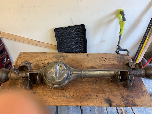

Full width front axle, starting point...
Committed now (or I should be! :lol: )

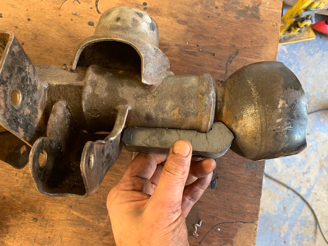

Ooops, the anglegrinder won't fit into the radius arm mount?!
Hand job it is then!
:lol: Awww, look at that bless it!

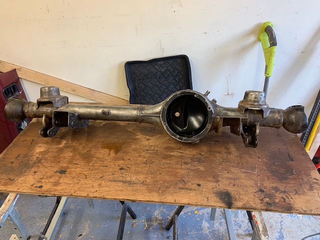

Looks better with the shafts in though, gives you a better idea of the final (50") track... (The Boogie is 65")
Bevelled up and ready to weld up...
I’ve ordered a length of M12 studding to insert through the axle and bolt it up with big washers on the end to keep everything in place and aligned for welding up. Something a "friend in the industry" suggested, and what I’ve seem done similar on “Texax Metal” on the Discovery Channel.
Some thick wall box section based gussets will be added like this, and the -
Ball gussets (also from a friend in the industry) under the axle too...
