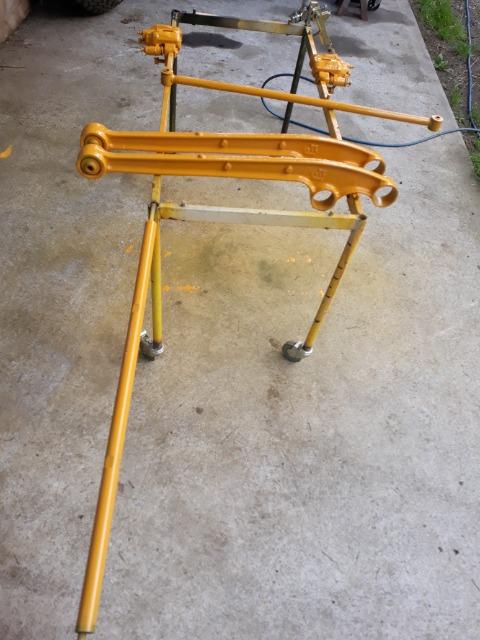

- X8GGY
22 Aug 2021 19:41 #237793
Replied by X8GGY on topic Dave’s long-term Lil’Bugga Buggy Build
Loving the egg yellowGoing to add a little yellow, tipping my hat to your build Dave.

Hi Dave what your doing all looks good to me, in an ideal world your radius arms want to be further out away from the diff but then your going to run into clearance issues when on full lock, I don't think having them so close together will be an issue for a rock buggy , be different if it was a highway machine and you were steaming through corners at 70 mph
I was asking about longer springs as I need to sort out what I'm doing, l like the idea of standard jimny suspension just with longer springs and shocks, I see there is some plus 4" springs and shocks on jimny bits for £279 which I might go for, undecided at the moment
