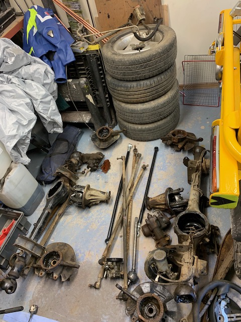

BUT... I still long for a tubular roll-caged / framed single seater buggy, so in March I messaged our mate James Priestley (who breaks the odd Jimny) and gave him a list of what I was after..
In early April James messaged me back to say he had most of it amassed! Ummm, so in mid-April when lockdown restrictions allowed I went up and loaded the NGeeVee with bits! -
Two front axle casings / hubs
Two front diffs
One pair of (both) short front shafts (?!)
Four front radius arms
Two sets of steering bars
Two power steering boxes
One power steering pump
One power steering reservoir tank
Four alloy wheels
A pair of JimnyBits HD panhard rods
Hmmm...
Yes, starting in the winter, I’m going to attempt to start building a four wheel drive, four wheel steer, four wheel disk braked (fiddle brakes then.) off-road-only buggy... just for the fun and challenge of building it, and possibly the odd AWDC competition, if and when it gets finished...

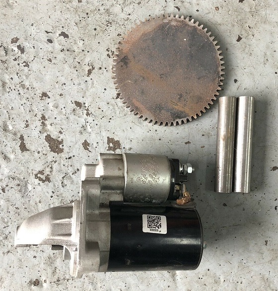

I’ve also picked up a reverse (starter) motor kit, as it will undoubtedly be bike engine based...

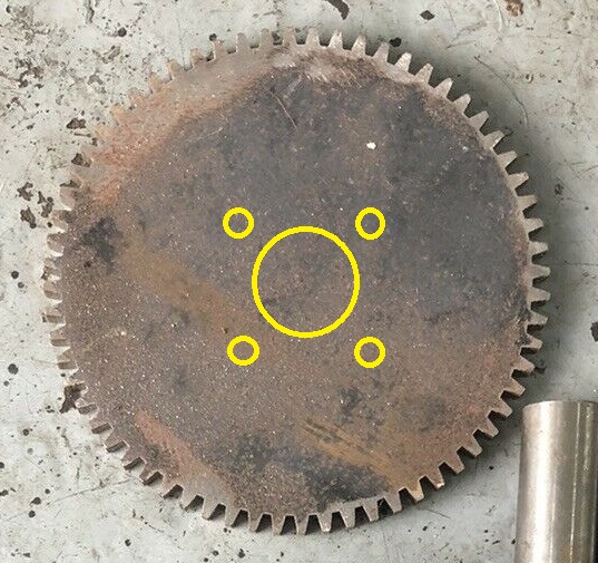

so it will be drilled thus -
to fit on the intermediary prop between the bike engine and the rocklobster transfer box I also have sat around...

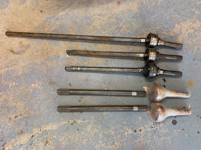

At the start of our latest greenlaning trip Riccy gave me an additional short front shaft in some kind of deal with James, and lent me a long shaft to have a look at and a measure -
So at the top, a long shaft to measure to work out the difference between it and a short one, as that's how much will need removing from the two front axle tubes... The two short sided standard 22 spline shafts for the front front axle
And at the bottom two TrailGear 26 spline HD short shafts and HD CVs for the rear front axle... :lol:
During a WhatsApp conversation with Riccy he pointed out that the rear front axle will turn the wrong way... (and try and tear the lil'bugga apart!) I'd thought about if for a while in the shop, weirdly twirling my fingers trying to work out the rotation of the props, etc. and thought it would work! :lol: But no worries -
Referencing this old photo from the Boogie build thread, you can see that a Jimny's front diff is high-pinnion, the pinnion is at the top where the prop enters the back of the diff, so I'm hoping I should just be able to flip the diff over, make it low pinnion (more oil for the pinnion!) and that will make the rotation right...

The idea of building Little Buggy with 4 wheel steer will give you an amazing turning circle but as has been pointed out you will have trouble with diff. rotation, so I have a few points to consider.
If you turn the diff round to give a low pinion set-up you will/may have the problem of the crown wheel hitting the wall of the diff. housing. This is the part that has the filler plug. You can overcome this by, knocking out the indent, or cutting the whole back plate off and turning 180 deg. and relocating the filler plug.
Or,
Keep the rear diff casing as is and grafting on the hubs from the front axle.
First idea is probably the easiest with the last the hardest. It's all about getting the alignment right.
