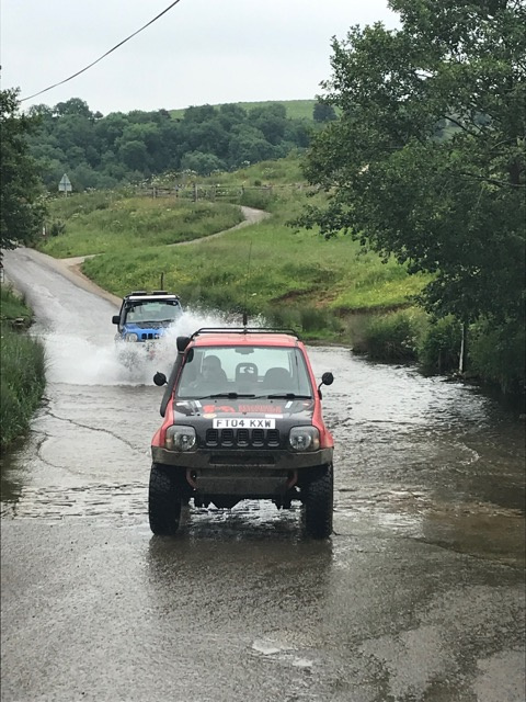

jackonlyjack (pictured at the ford above) gave me a nudge when I was last out in the Lakes with Riccy. We had completed a river crossing and jack mentioned that I was pushing my luck with the amount of wading I did, not having a snorkel....

jackonlyjack was only partially right, wading was going to cause me a problem, but not from the lack of a snorkel. Breathers or the lack of extended breathers was the thing that bit me on the bum....
My front axle had a faulty breather and flooded, causing the dreaded death wobble to return. I had rebuilt one hub and the other was stripped and greased at the same time, a big and costly job.
I considered just repairing the offside hub but felt that the dirty water would have contaminated the bearings on both sides. I decided to rebuild the full axle and fit breathers.

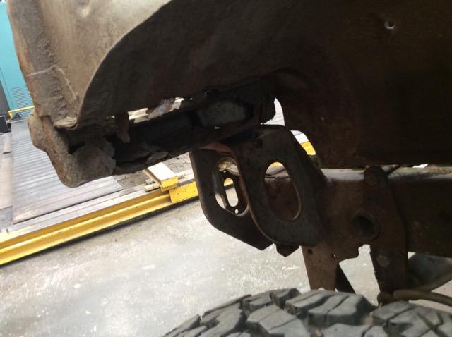

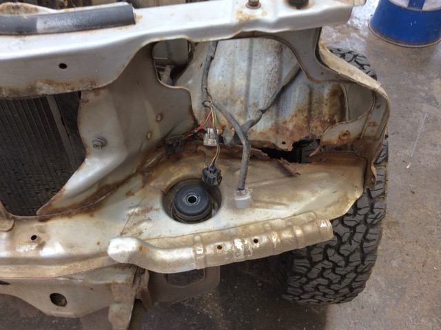

Whilst at JP 4x4, John had noticed some rust on a rear mount and gave it a poke as mechanics do, it pushed through.....
I had removed the front inner arches and found some rust on the front mounts, I intended to get that welded before this years MOT in June.
It was beginning to look like the £200 pounds I had guessed at for rust repairs was not going to be enough. Enquiries were made and estimates received, £700 was going to be closer to the mark.

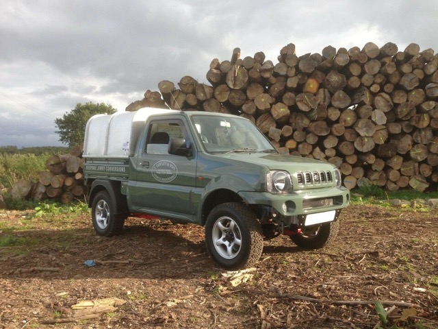

At this point I called in to see a local bodyshop, Terry Lofely & Son in Shirebrook. Terry and his son Reece have been working with Jimny's for some time, completing amongst others, a very high standard pick conversion that they now use as a shop truck.
This truck had a total strip down and rebuild with all new or reconditioned parts.
As you can see, proper work, done by tradesmen. The chassis on the pick up is extended giving a 90' wheelbase, gives a more usable load bed but also imbues the car with a very different driving experience, much smoother and less prone to bouncing about. (It's for sale at 10k)
I made my mind up that this was where I wanted to spend my money.

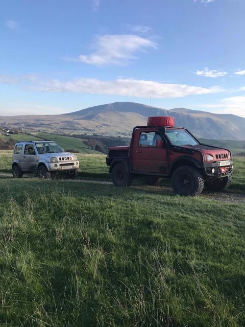

Now we bring Riccy to the story....
His car (in front of mine) had always impressed me, it is a cracking build and I like the "truck cab" look. A lot.

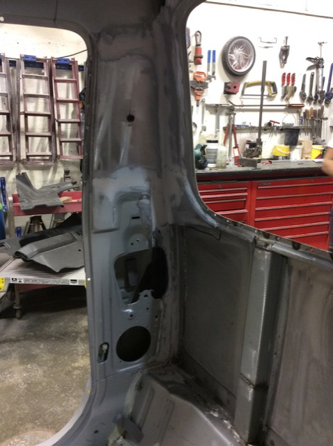

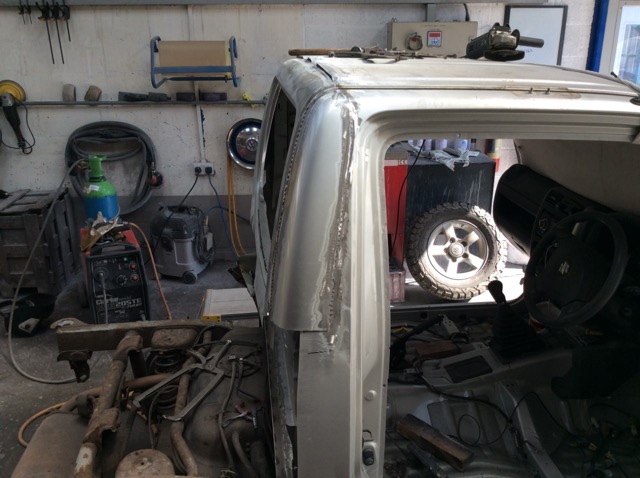

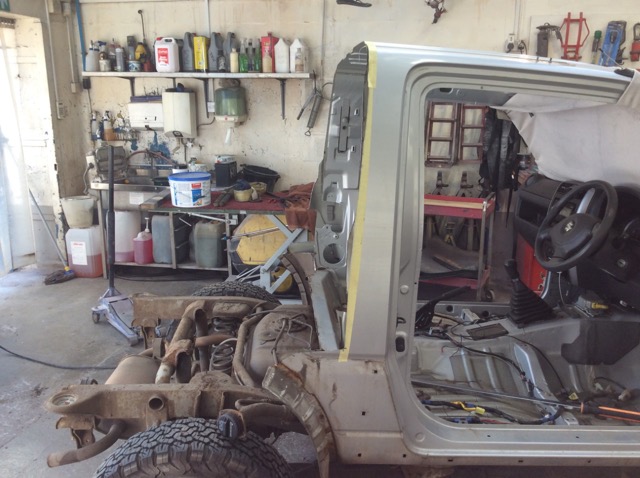

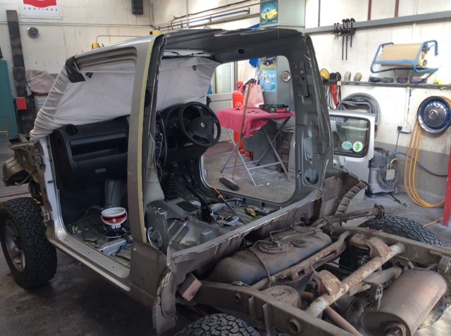

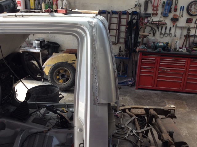

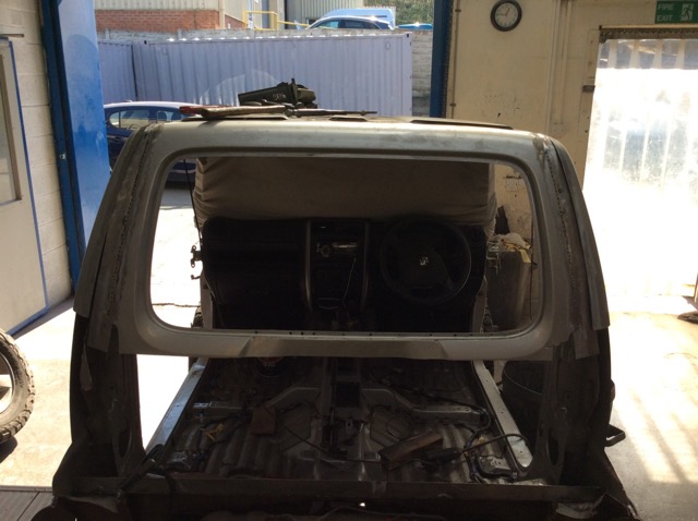

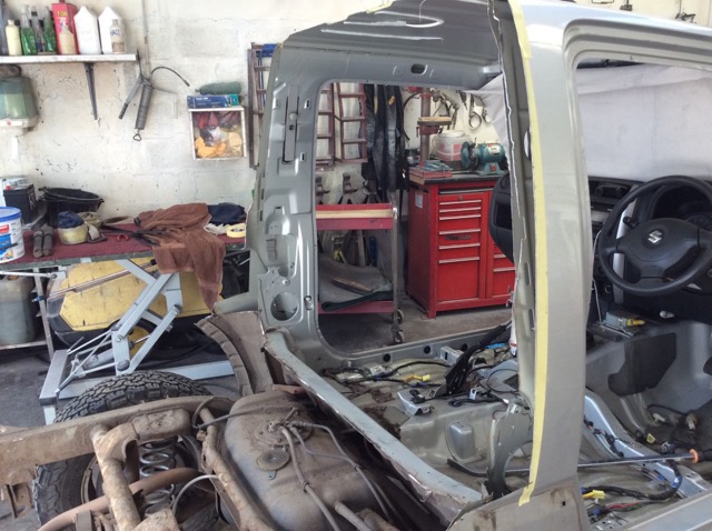

I spoke to Terry Lofely and agreed a price that would see my car have a full cab off restoration on the underside of the body, with a Raptor respray.
It was also agreed that given the amount of rust repair that was required, it would be just as easy to do a cab conversion and not much more money.
The car was delivered to Terry last Monday.

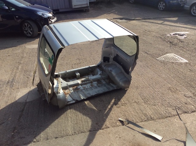

The front was found to be pretty bad and well, as for the back.....
That was the only thing to do with it.......
This was the end of day one.....
