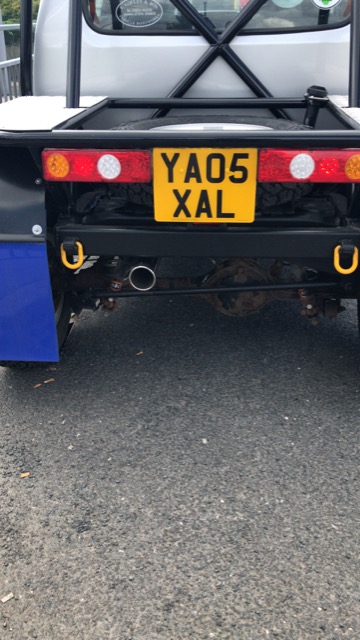

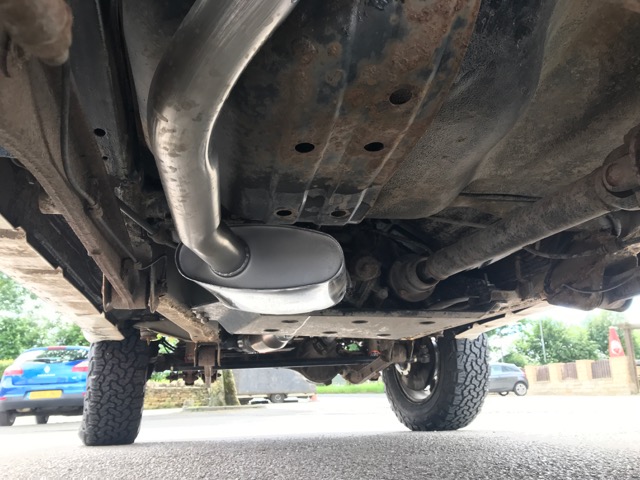

Well impressed with the new exhaust from Tony Banks..... The Aussie "Wildcat" headers (4-2-1 manifold in English) were fitted along with a sports cat and a 2" single box system. The box sits nicely between the transfer box and the fuel tank, it should be safe.... Tony was a nice bloke to deal with and I wouldn't hesitate to recommend him. When first quoting, he said that a cat back system for a standard Jimny would be around £300.
The plan has worked..... There is a lot more torque and you get it lower down
Even managed to spin the wheels up on the change from 1st to 2nd (in the wet and by accident...it's changed) A little disconcerting really, I had gotten used to how much throttle to use in the wet and it looks like I will have to learn again.... queue brown pants.....
Only a motorway drive home and it is much more responsive and eager to accelerate than before.

Very cool. So it's 421 manifold to second factory cat to 2 inch system or have you gone for a sports cat?

2" all the way with a sports cat Lambert.... Wait til you hear it, sounds great.
A bit over the top but it will cope with 200hp so I think I'll be ok if I make it to a 1600 lol...

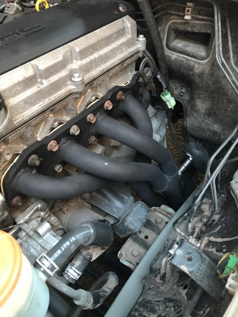

Had the bonnet up...... The manifold does radiate heat but it seems manageable, it certainly looks the part and works as well as it looks.
The hole at the bottom of second gear is still there but it is not so deep and the engine now climbs out with less struggle.

Could you use the holes in the head above the manifold to secure a heat shield keeping the heat from accumulation under the bonnet?
