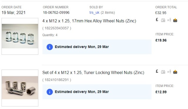

19 Mar 2021 13:02 #233845
Replied by X8GGY on topic Re:Dave's la(te)st buggy build...
:lol: Spoke to soon! :lol:
My insurance company insisted on there being locking wheel nuts fitted...
So when I went to order them, I spotted wheel nuts with 17mm heads instead of the normal 19mm heads, this will sort the closeness of the nuts to the Grand Vitara alloys
So I can use a normal wheel nut spider or socket and bar...
