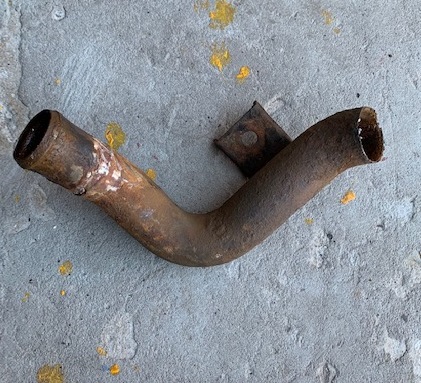

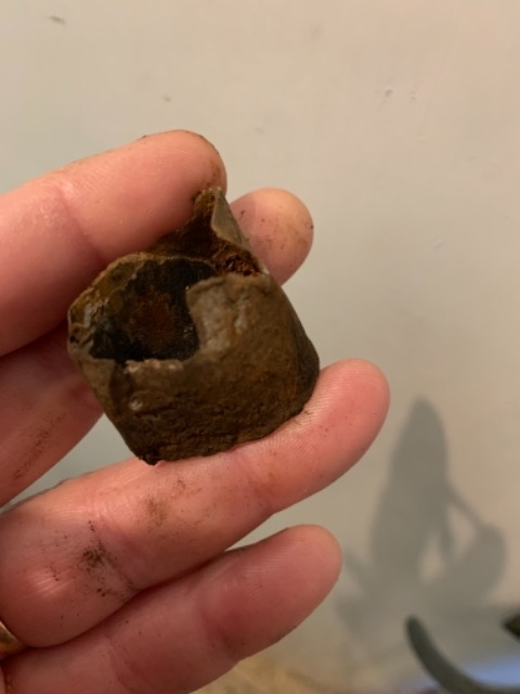

This is the end of the metal pipe off the engine that goes into the bottom hose of the radiator -
We had to pull it out of the hose and relocate the hose so it stayed on the end as a get-me-home fix... So I need to see the condition of the rest of the metal pipe... if it's sound* I can use a slightly longer rubber hose, if not I'll have to see if I can get a replacement metal pipe off the engine?
*I presume condensation/ road spray has run down the metal pipe to where it meets the rubber hose and settled there and in the twenty years of the Jimnys life it's slowly rusted through, and the off-road wobbling of the engine has caused it to shear off...?
- X8GGY

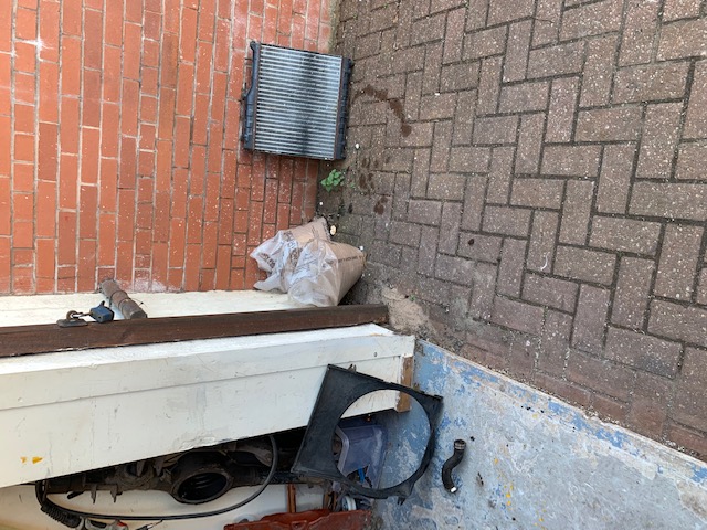

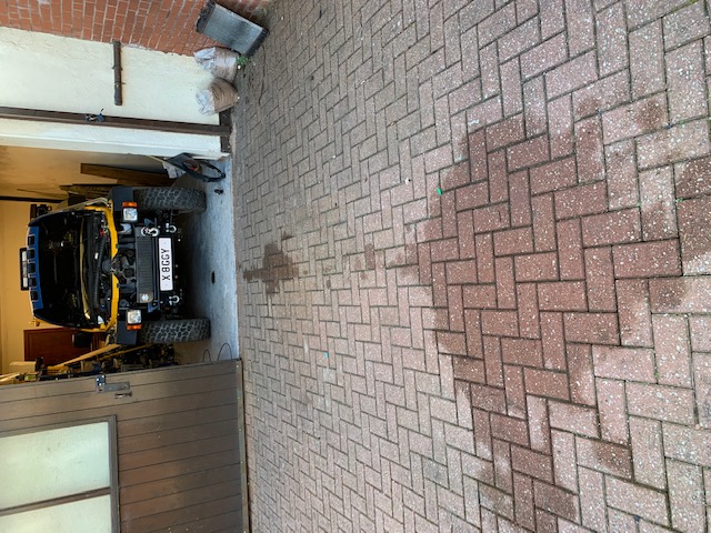

A couple of hours off this afternoon... So...

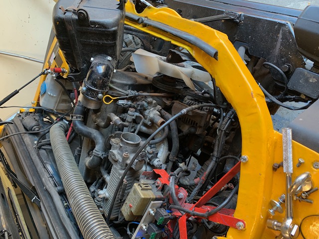

Pulled the buggy out of the garage and popped the radiator hoses off...
Pushed it back into the garage and whipped the radiator out...
Little rusty bit of pipe identified...

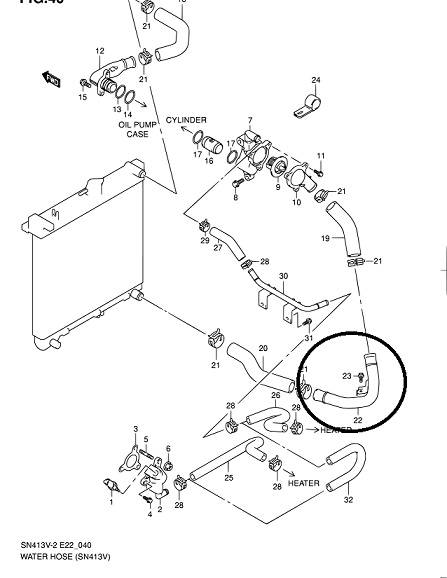

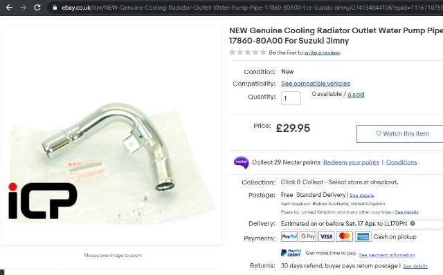

Number 22 ringed here is Suzuki part number 17860-80A00

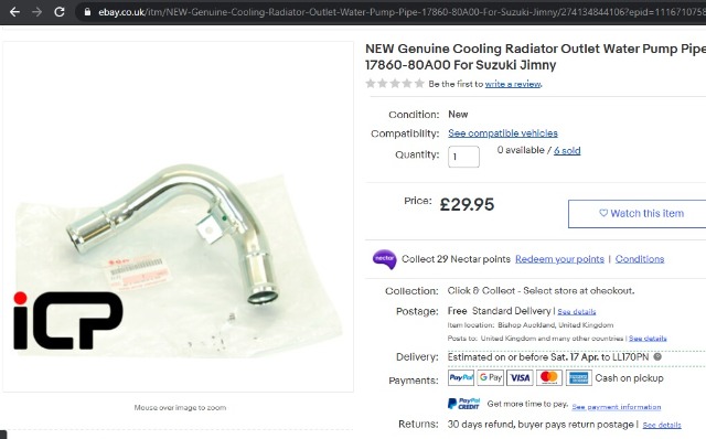

Found on eBay -
And is on it's way
Well... after the bank holiday... delivery before next Saturday it said... which is ok as I've lost my Wednesday off as one of the girls has booked next week off...
Found on eBay -
And is on it's way

Would you believe...
... an hour and a half to get this small piece of steel pipe out this morning?!
Who in their right mind at Suzuki HQ thought "hmmm, yes, let's put the radiaror pipe through the engine mount..." WTF?! :evil:
It wouldn't have been so bad if it was a rubber hose? But no, rubber hose off the engine, steel pipe through the body mount, and then rubber pipe to the bottom radiator connector?!
I had to take the repositioned airbox out in the end to get to the hose clip...

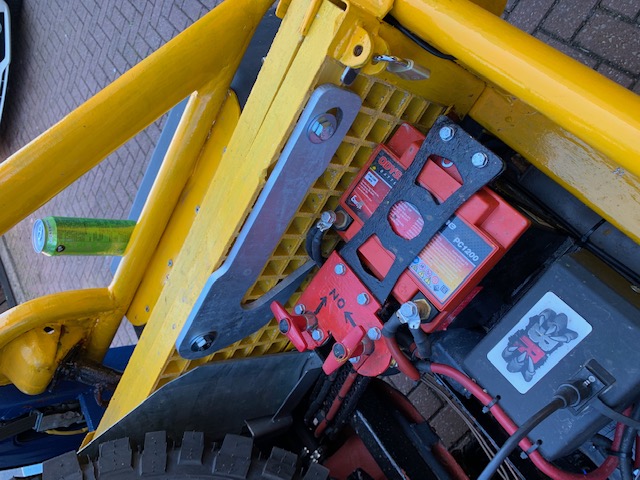

I found the stump / rock hook that Alan had given me for Christmas, and stared long and hard figuring out where to mount it... not being able to weld to my new creation I decided to neatly bolt it through the two waffle boards...
