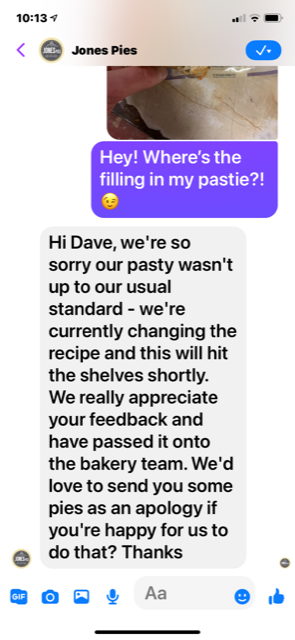

When I was working on the Boogie's brakes on Wednesday I had a cuppa and one of Jones' Pies excellent products as they are usually full to the brim with lovely filling...
Only...
This time I had an air Pastie!!
At the time I chuckled \about it and went back in the shop to get a Steak and Ale Pie and put the pastie in the fridge to complain to the pie-man on Thursday morning when he next delivered..
I then thought I had seen them on Facebook, so I sent them a message -
And they offered to compensate me with some free replacement pies! :woohoo:

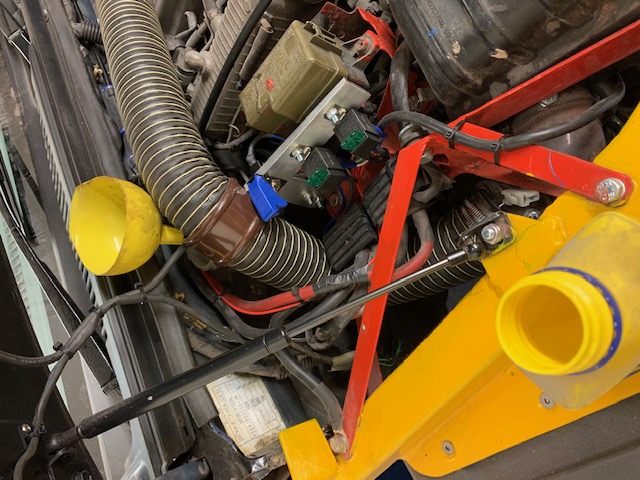

05 Mar 2021 20:54 #233469
But when your house has 21 rdiators it requires a boiler the size of a washing machine
It's definately a "gas 'eater"
Possibly Yes :laugh:LM42 wrote: bit over the top for in car heating?

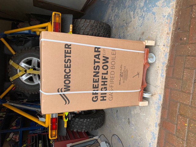

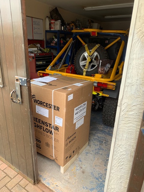

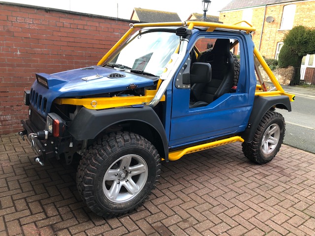

Bit more today... only the new boiler was in the way...
So I stuck a (bread) trolley under it and rolled it next door to the shop and popped it in the storeroom...
First job was to change the front number plate back to the old one it's registered as...
Second job was to fit a seal to the filler plug on the front diff (thanks to Martin's store for that!)
Third job was to slide around the painted concrete floor checking everything was in place, wires ty-wrapped neatly, all nuts and bolts nice and tight...
Then...

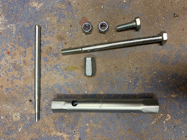

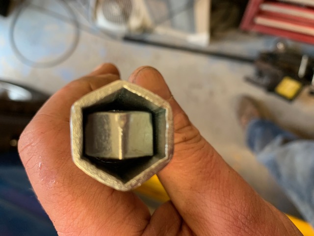

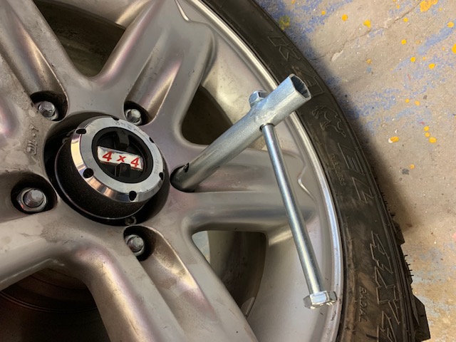

As the Boogie (as it is now to be called thanks to Alan's keyring - see a few posts back in this thread) has GV alloy wheels on it, they are very tight round the nuts, this box spanner works well but the handle slides in and out, and often falls out...!
Cut the M10 'joining nut' in half and force it down the centre until it meets the opposite end's holes...
And then thread the bolt through it and lock it all in place with a nyloc nut on the pointy-out threads...

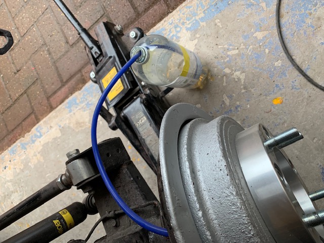

Then I was able to take the wheels off in turn, and...
Bleed the brakes, with the assistance of our eldest daughter :lol:
Who put that convulted snorkel hose in the way? :lol:
And, ummm...
I think it's finished!!!
Just waiting now to see what happens with the COVID lockdown(s) as to when we're allowed out to greenlane, and then I'll insure it and take it for the MOT... Gulp!
There is a few tinkering / nice-ities to do to keep me busy in the meantime though -
iPad mount
Alan's Potti mount (map reading light / magnifier)
Storage needs sorting for recovery equipment / maps / butties (when we're not eating hot pies!)
Tool bag needs restocking after a year off!
