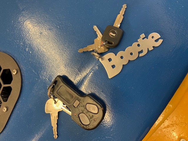

I sorted the keys out... the bunch on the right are mine - the driver's - main ignition key, key to the lockable fuel filler cap, and a key for all the padlocks.... And the bunch on the left are for the co-driver (mostly our Alan when he's ready to return
) so there's the remote for the winch, a spare ignition key (with no imobiliser fob) to get in the glovegox (but can be used if the ignition key snaped to still start the vehicle), a key to the fuel cap and another key for all the padlocks...

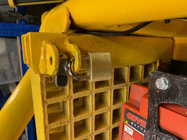

I bought a set of four matching-keyed padlocks some time ago...

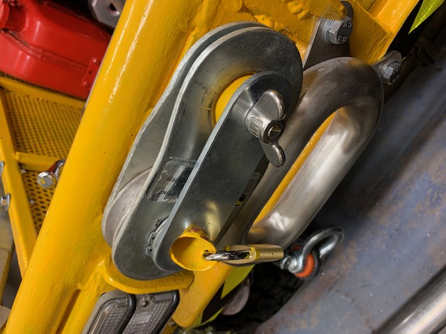

One for the snatch block (winch pulley that is used to winch backwards when a loop of rope is taken off the drum through that giant hawse fairlead).
One for the waffle boards... there's a bolt with a wing-nut going through them to hold them securely when greenlaning, but when parked (overnight sometimes outside a pub with rooms

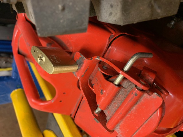

One for the fake jerry can which houses the quick strop / tree strop (a loop of webbing strap with a big loop at one end and a hook on the other, so you throw it round a tree and clip the hook through the ring to winch to safety) .

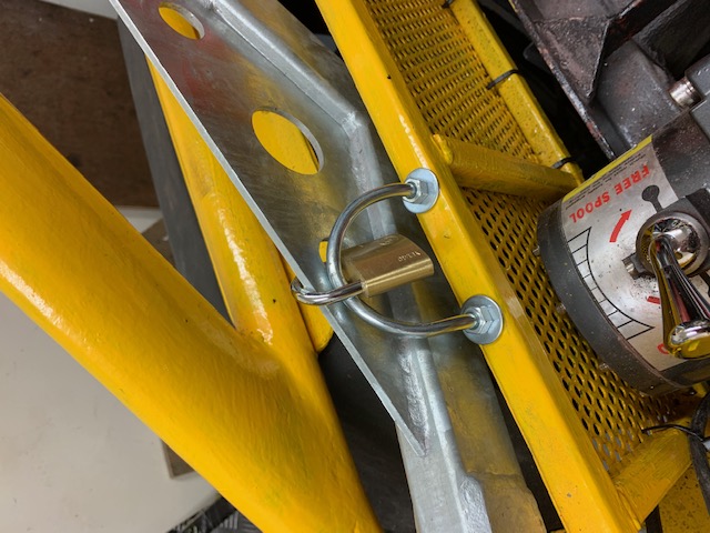

I spent a good while trying to think of a way to stop the ground anchor going astray... it's bolted to the rear tray's elliptical diagonal stays with two M12 wingnuts, but is a bit easy to steal, so...
I bolted a U-bolt through the little perforated steel 'wall' to match the waffle boards on the other side, and the fourth padlock stops that wandering off too...
