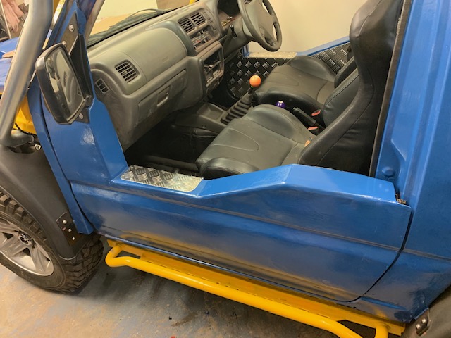

And today...

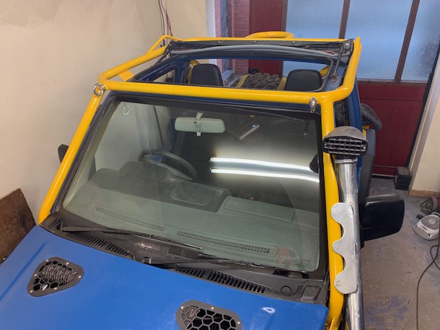

Finally filled the diffs and transfer box with oil, and drove the buggy (!) out of the garage, turned it round and popped it back in ready to...

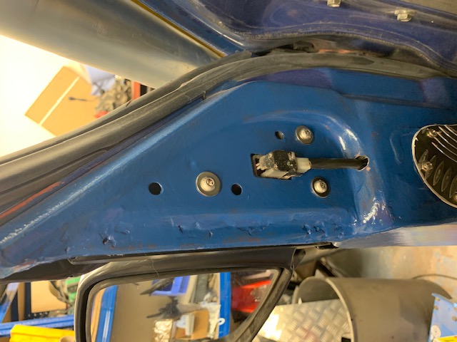

Solder up and heat shrink the mirror control wires, and all the unused wires in the passenger (Alan's?) door...

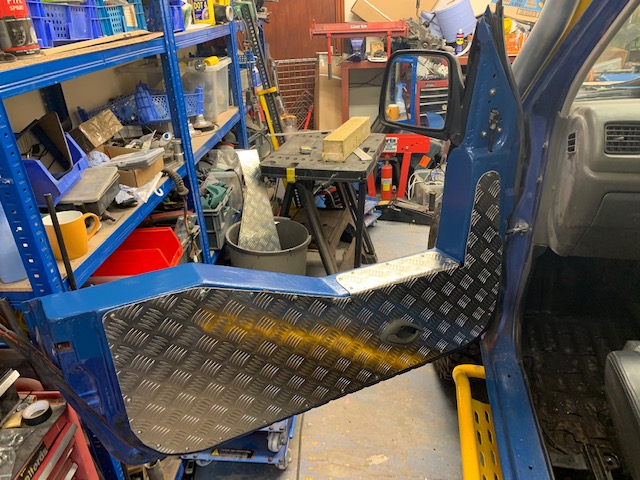

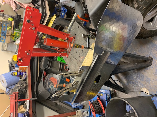

Back to the cardboard template for the door cards... test fitted, checked, made and fitted a bracket to hold the door handle, test fitted again... cut the aluminium chequer plate, test fitted it, drilled loads of holes in it, bent it using he same method as before, only the wife was working so her weight was replaced with the pipe bender on the other end of the bench :laugh:
Cut, bend, attached
Fake step...
So another two items off the list... errrr, that just leaves the front brakes to re-plumb then?!

Ended the day...
Sat in it... played with the mirror remote switch until both mirrors were correctly aligned, and then threw the soft-top roof back and just sat there drinking a cuppa and munching a biscuit, smiling to myself... :lol:

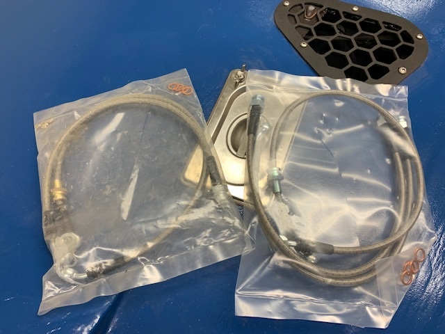

When I started the buggy nearly two years ago... I bought a TrailGear extended brake line kit (on the left) from JimnyBits, and have so far only used the rear extended braided brakeline, i figured recently with the front inner wings "gone" it would be easier to use two driver's side front brake lines, as the bassenger side used to come in half way up the inner wing and had a short section of the flexi going down to the square mount where the clip goes on... With the inner wings now gone, I figured I'd cut and join or re-bend the existing passenger side copper tube run to therefore meet up with the top of the mount as per the driver's side...
Therefore I needed another driver's side flexi braided brake hose... I went back to the JimnyBits store and the TrailGear extended brakeline kits were out of stock, so too were the plain coloured kits of "their own", presuming these came from Llama4x4 I picked up a set off them off eBay... I know, I could have rung them and asked for just a single driver's side hose... but having spoken to Dave Round @ Llama in the past I chose not to :laugh: as I didn't have half a day to spare :woohoo: ... so I just orrdered a complete kit, I'll use the driver's side flexi out of it and re-sell the two passanger side ones, and keep the rear in my spares box...
So the driver's side flexi will "just" bolt on - I hope - and the passenger side will have the coper brake pipe either moved / re-bent to match, or I'll cut and add a new section if necessary...
I'll have a look on Sunday, see what I can do... I've still got Alan's flaring tool, bendy machine, and most of a roll of copper tube ready and waiting in the the garage...
