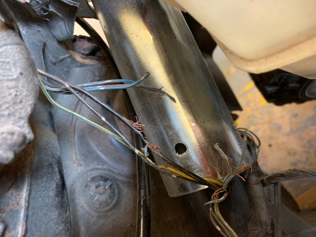

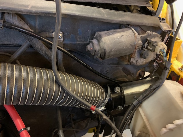

More wiring! These are the wiper motor wires I caught with the angle grinder when cutting the inner wings off

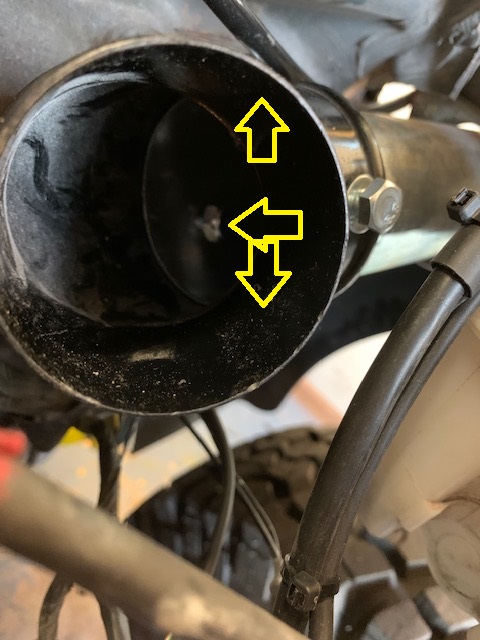

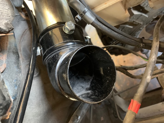

And that's the end of the snorkel tube on the passenger side... note the holes in the plated tube...
Yes, there's four of them! And a bit of a design flaw in this... getting the nuts on the bolts! Inside the tube, and bast a 45 degree angle bend! :ohmy:
Got there - in the end - though, double jointed fingers, various spanners and sockets, and a good blob of Blu-Tac! :laugh:
And finally the convoluted tube can be attached with a nice big jubillee clip...

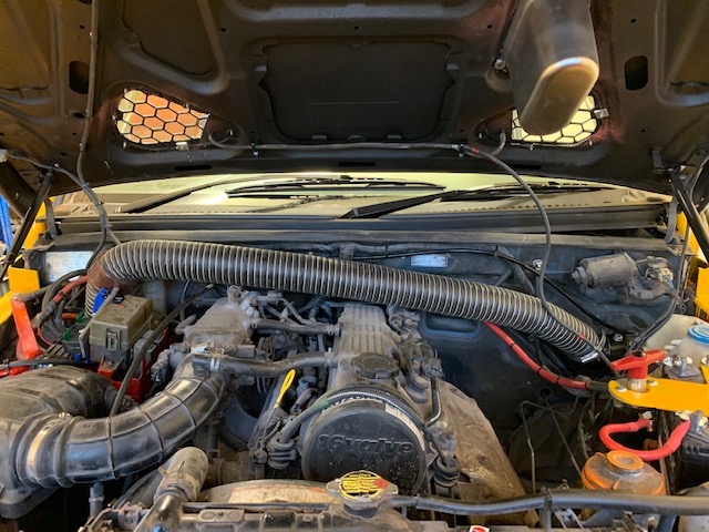

And that then runs across the engne bay...

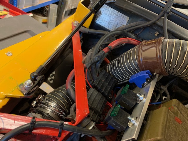

Over the brake fluid reservoir*, behind the fuse box, and the new headlight control relays, and all the winch / battery cable joint blocks, and then snakes under the meet the relocated airbox... Note the band around the convuled tube to stop it rubbing on the relay / switch aluminium bracket

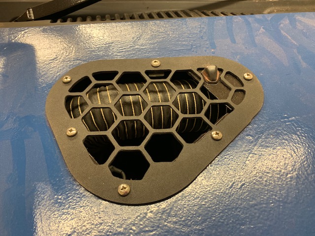

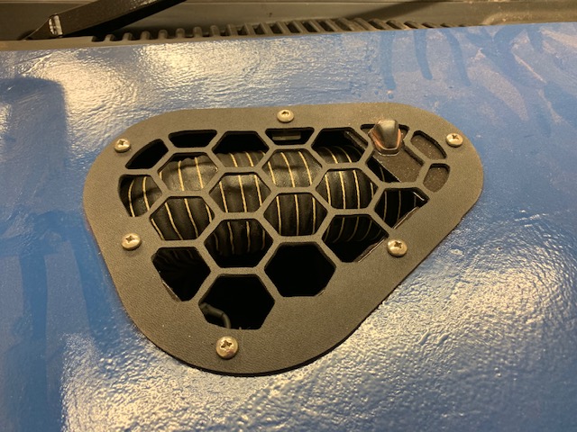

There's the hose seen through the Keithy bonnet vents
So I ended the day chuffed... the wiring is finished, I also did the passenger side repeater on the bonnet edge, got the wipers working - eventually! after a new fuse was fitted
, the windscreen squirters wired and plumbed in and neatly attached to the underside of the bonnet...

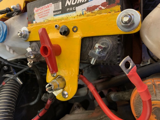

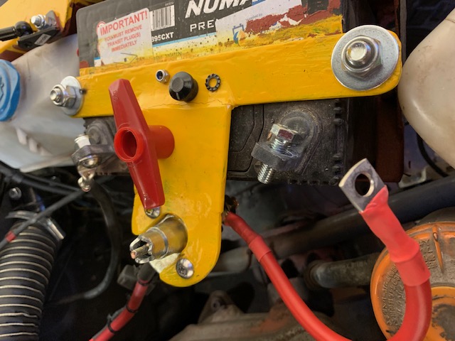

And then, I went to switch the battery isolator to "off", and noticed the ignition lights were still on the dashboard? After some invesitgating I found the handle had unwound it's nyloc securing nut, and there's no way to fix it as the threaded pin is sprung downwards, so it's impossible to get the washer and nyloc nut back on?! So I've messaged the seller on eBay to say I'm not happy! :devil: But the back two switches have always been fine? Might just be a fluke, a duff switch, but it looks like it is good pratice to always switch the off or on by rotating the T-handle clockwise so that the nut can not loosen?... :ohmy:

Rivnuts would have worked wonders on that bend!

Indeed! Told you it was a design flaw! :lol:
