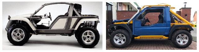

Just looking at design / styling cues...

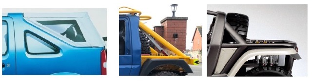

The rear diagonal brace replicates the upper edge of the soft-top's little triangular window, so much so I've left the front edge of the window frame in place, it then tries to look a bit like the EX rear stay, but obviously a lot longer. Sourcing the ellipical tube was fun, but I found some in the end!

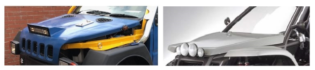

The bonnet shape and edge (made from oval steel tube bent to suit) has been inspired from staring at the EX, on my first attempt at a Jimny buggy I cut the five oval holes off the original Jimny bonnet, but in this one I left them on, partly so it still resembles it's Jimny donor, and secondly for ease of build. The light bar is a bit of a modern nod to the EX's spotlights... they'd soon be ripped off greenlaning though!

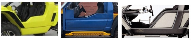

The (half-)door shape is a nod towards the UTV's shape... the EX shape would be no good for protecttion from side impacts and the ingree of water when fording streams and rivers, so my Buggy was formed to be a bit more water-tight for our weather and fording ability... and safety / passing inspections...

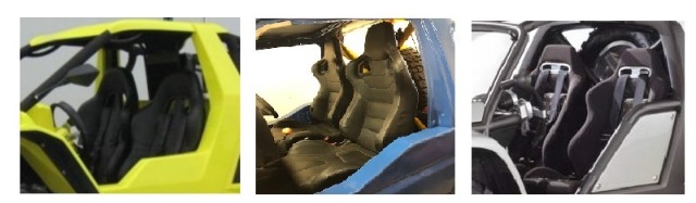

BIG seats filling the cab!

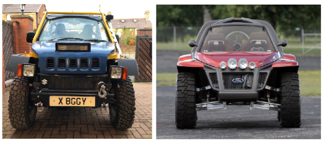

The bumper-ette had to be considerably wider on mine to cover the chassis ends, etc... and house a number plate which they don't need in the USA, and it also had to have headlights of course, so I opted for the JCB complete unites... Amd the width of the radiator, the chassis rails (with the winch rope tube on top) are alo constraints...
So it's a nod to the design cues of the other two buggies I've taken inspiration from, but building around a Jimny underneath...
