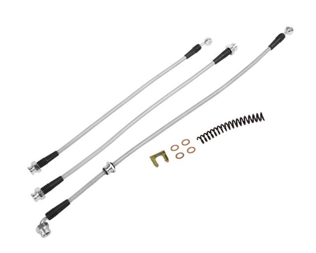

I was reading a FB post they mentioned attaching suitable length strength spring
Around brake hoses to pull them back into a desired location
Also allowing full articulation

Land Rover have something like a plastic spring on the front lines on defender.

And I like JackonlyJack's spring suggestion for brake pipes, very clever solution to keeping them clear. Llama4x4 will make up jimny hoses at any custom length and for a good price too

I've already got the brake hoses -
Stainless TrailGear ones from JimnyBits...
It's the actual brake pipes I need to re-route to the flexi hose connections, as the wings have gone!
I've got Alan's old faithful flaring and bending tools to assist with job, so that shouldn't be too bad a job...

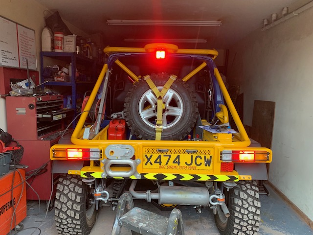

Another good day in the garage tpday...
Rear lights finished! The high-level brake light is wired up, and the guards are back on the SJ rear lights... So, that's the rear finished! The rear brakes have already been done, so I turned my attention to the front...

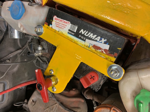

I made a bracket for the engine battery's isolation switch... just need to wire from the switch to the battery now...

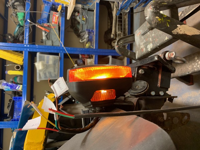

And then I final-fixed the JCB headlights and began fathoming out the wiring, what joins to what... you can see the indicator is "on" in this photo, it wasn't a lucky shot with the camera
I ran a cable from the side lights and used that to work out what wire did what in the JCB headlights... So I think I'm all ready to wire up the headlights on Sunday

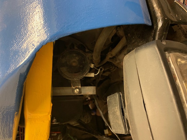

The horn still works! So that was attached to the bracket that holds the front of the relocated air-box...
