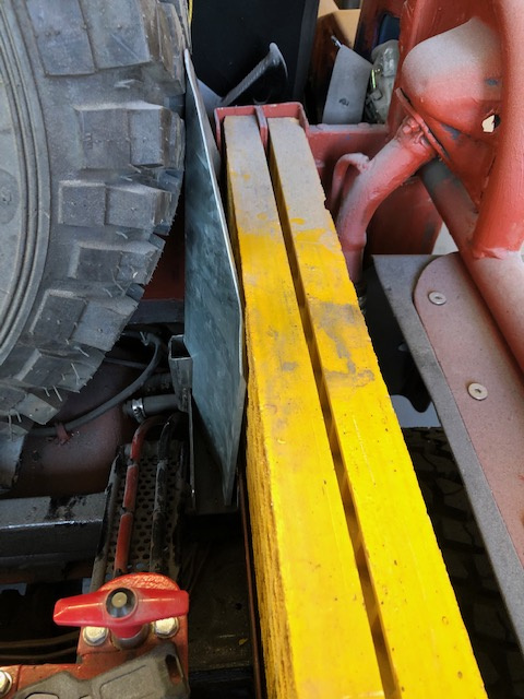

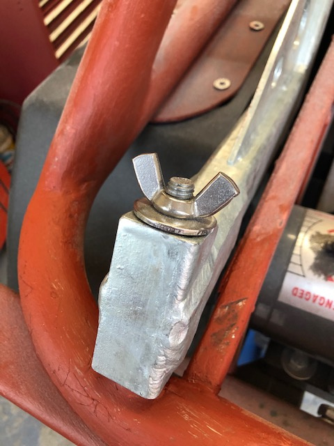

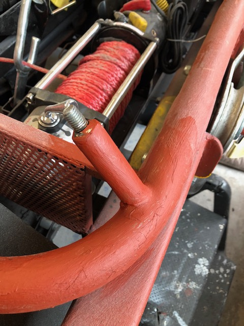

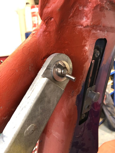

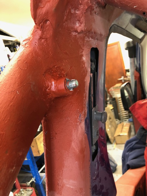

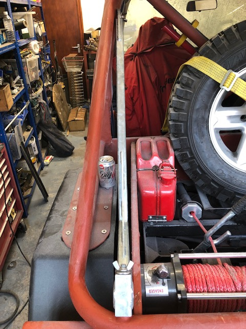

Thought I'd make the mounts for the ground anchor...
Bottom mount on the hoop of the rear 'tray' ?
Top mount on the original soft-top roof hoop and added elliptical stays that meet the top of the rear tray hoop...
So that the ground anchor's handle / shaft mounts nicely here... parallel to the arch and perforated side wal of the tray.
Wing-nit here
And a wing-nut here, make it quick to access... not that I use one much, but you never know...

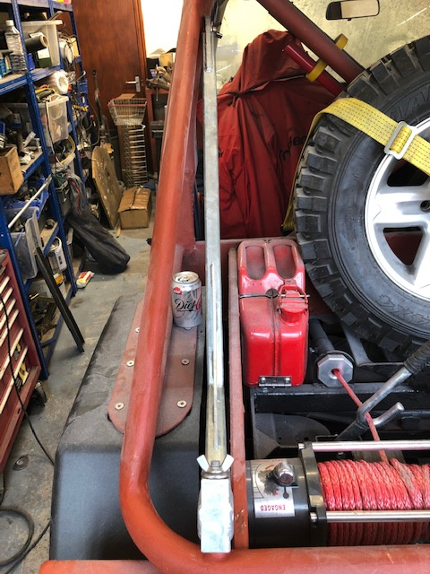

The a mount for the 'spade' bit... a couple of bits of box section... the bottom U to hold the spade, and a longer upright to go around the central square bar mount...
And then bolts down here... it's tight between the spare wheel's tyre and the waffle board, and a bit of gravity will also hold it in place... once the tyre is ratchet strapped down it doesn't move or rattle...
And that took me all blummin' day!
I had to re-engineer the top mount a couple of times, as the shaft would fit onto the bottom 'peg' but then wouldn't fit on the top mount... got there in the end though, after plenty of eff'ing and jeff'ing... :lol:
Wing-nit here

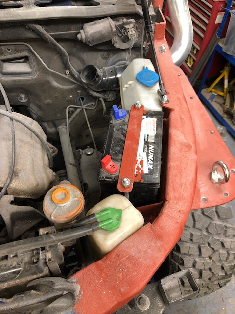

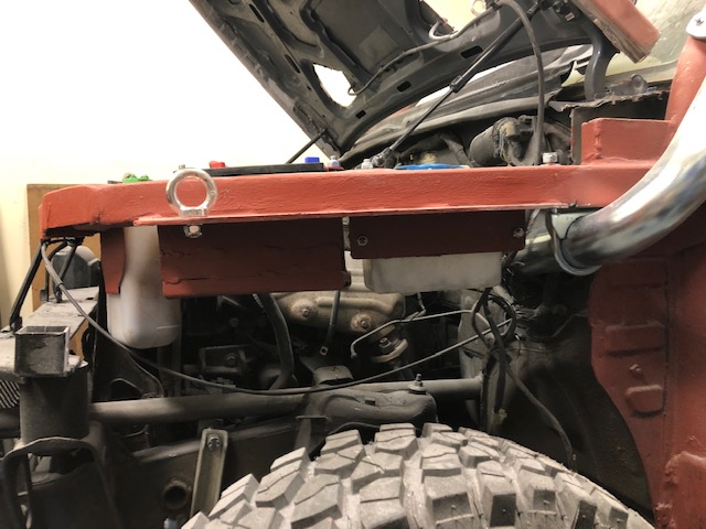

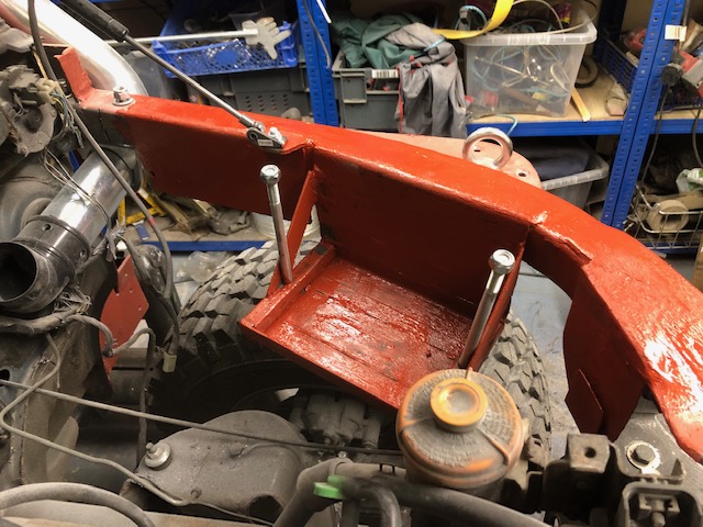

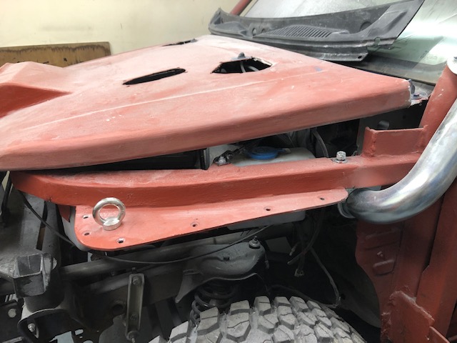

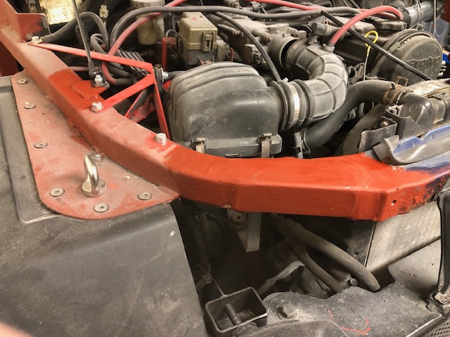

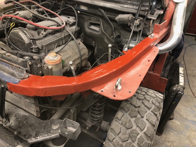

My plan was to get most of the bonnet area finished...
So the engine ancillaries brackets on the passenger side, and blend the new "bent box" wing into the stock bonnet slam panel...
So, on the left the bottle for the wishy-washers, the (engine) battery in the middle, and the radiator expansion tank on the right...
And also on the driver's side... blend the "bent box" wing into the bonnet slam panel again...
I also fitted bigger stronger brackets for the ends of the bonnet struts too...
Paint dry, and mount the ancillaries for a test-fit... all good
So these all sit at the top of the "wing" obscured by the (lorry) plastic wheel arch, and high enough to be out of the way at full articulation... (not that there's much remember, as it's only running a ~1.5" lift)
With the bonnet shut you can't see much...
Just the side repeaters for the indicators to do now then... they are going on the bonnet edge... should get to doing them this week hopefully...

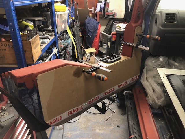

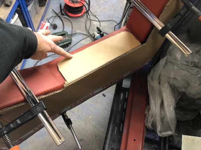

Anyway, I'm keen to get this finished and get out 'laning again... I had a good day on Sunday so was re-invigorated, so having a few hours off this afternoon I retreated from the weather and into the garage...

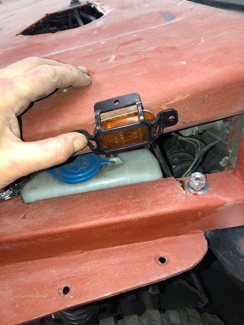

First I retrieved a spare wing from behind the garage and drew inside the repeater mounting hole to mate a cardboard template, cut it out and used it to drill, angle-grind and then Dremmel the hole the right size into the side of the bonnet's new edge and fitted the repeater through it, and then bent the JimnyBits repeater guard in the vice with a pry-bar so that it fits around the bonnet edge... Just have to repeat this on the other side later too... easier now I know what I'm doing!

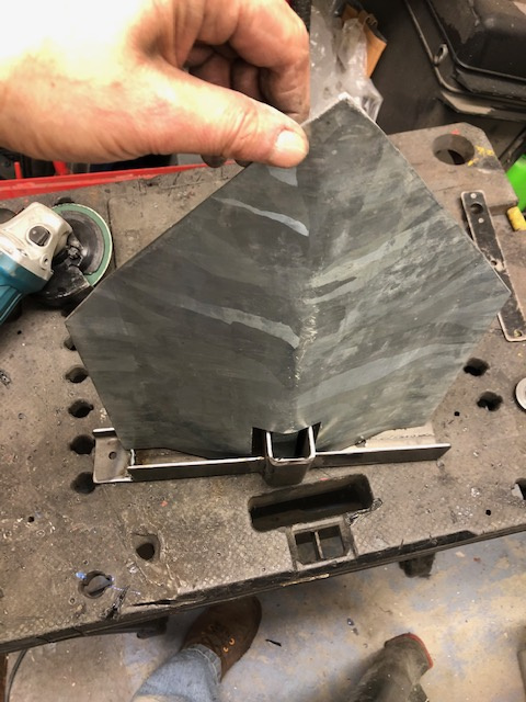

I then got a bigger piece of cardboard - handy being a shopkeeper, plenty of boxes! :laugh: - and drew around one of the door cards I kept ready as a pattern... I then cut it out, and then offered it up to the half-door to mark it some more for where the door has been cut...
So that it will cover the inner door skin, and also...
... wrap round over the top and into the "step" in the lower bit of the half-door...
