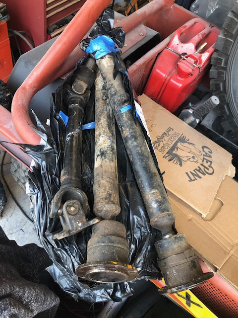

I'd asked our friend James J999PRE to lookout for a spare front and rear propshaft for me... I want to carry at least a rear one just in case!...
And then another mate said he'd got this -
So I half-jokingly asked whether the rear prop was intact?! :laugh: Apparently it WAS ?! So I'd asked if he was breaking it to put my name on the front and rear props...
I then went to eBay and found a deal too good to miss -
Two rear props and an intermediary for £50 plus delivery, so I clicked "Buy-It-Now" on them before anyone else spotted them, and waited a week for them to arrive... meanwhile Brett (Maverick on here) had been over to buy some other parts of the wrecker above and has got the front and rear props for me, so I can pick the best of the bunch of the rear ones, and keep them as spares or sell them on if anyone is looking for one in the future... Brett's over on Sunday as we're going greenlaning locally to me with Riccy in Ulysses for the day :woohoo:

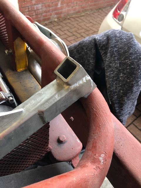

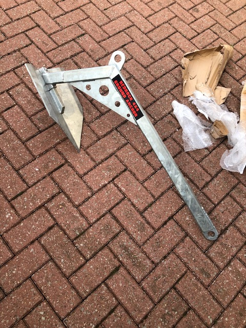

The ground anchor - used to winch off when there's no (pesky) trees around. You winch on the end and the spade bit digs itself into the ground to haul you out of whatever you're stuck in... I've had a few in my time, one similar to this before, one I made myself, and a folding spade one that opened out for use... This is the smaller model that they sell, suitable for Jimnys and the like...
Well made, and nice thick steel, it'll do the job nicely...

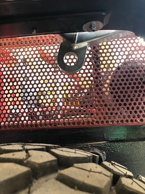

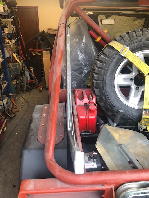

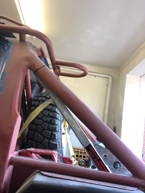

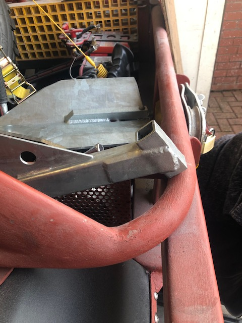

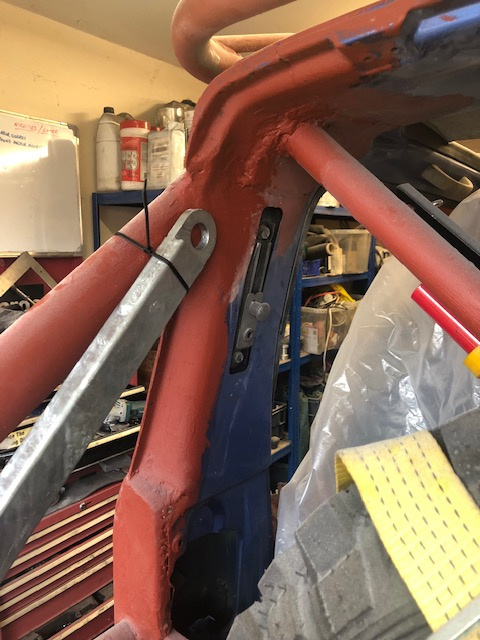

I had a good look at the back end to find a suitable mounting point, and ended up...
On the passenger side - the waffle boards are on my side...
So to mount it I figure...
A one inch capped peg through the box section here...
And...
At the top a tube spacer with a thread on the end, through that hole, big washer, wing nut... and another padlock
The 'kink' in the arm ends up here, above the tyre but enough out of the way that it won't foul on the tyre under articulation... That loop hole is used to pull the anchor back out of the ground if it digs in too well! :laugh:
So the anchor arm sits like this ^^^

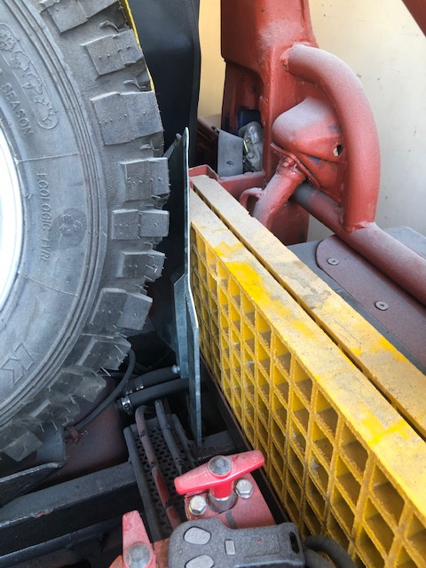

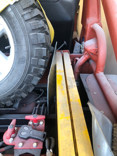

The spade bit...
Should sit neatly here between the spare wheel and the waffle boards...
Hence why I wanted the anchor now so that I can make the mounts before the final coat of paint goes on
