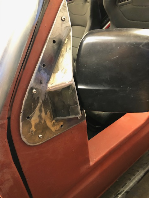

I started by drilling and riv-nut'ing the mirror guard(s) on... I drilled the top and bottom holes and riv-nut'ed the two in to hold the guard in position to drill all the rest, and then started riv-nut'ing the rest... until
one of the riv-nuts jammed in the gun and I struggled for a while to get the gun out of it, and ruined the thread on the head doing it... so I'll have to order a new one... I've had it a while though, so it's done a good few in it's life,,, Ho-Hum! So I had to leave that and carry on with other items on the list...

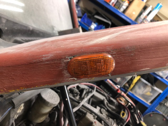

Drilled, cut and shaped the mounting hole for the the other side repeater in the bonnet edge on the driver's side...

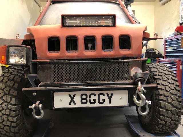

I then drilled the front number plate and then the mounts in the front bumper(ette)...

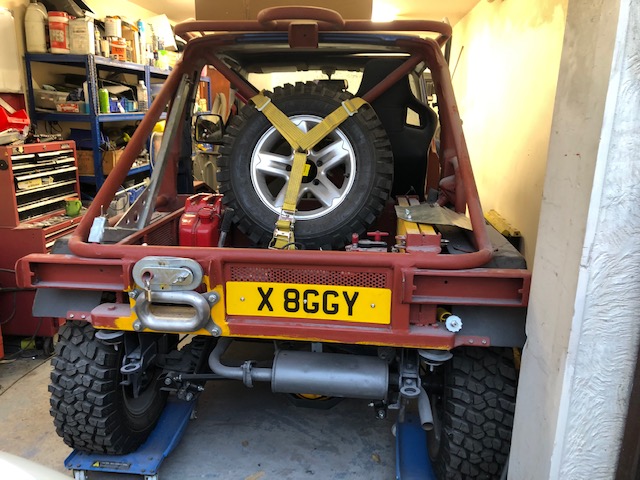

And then the same in the back... Still need to drill and (temporary before paint) mount the two LED number plate lights...
