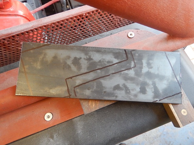

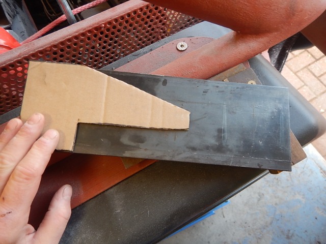

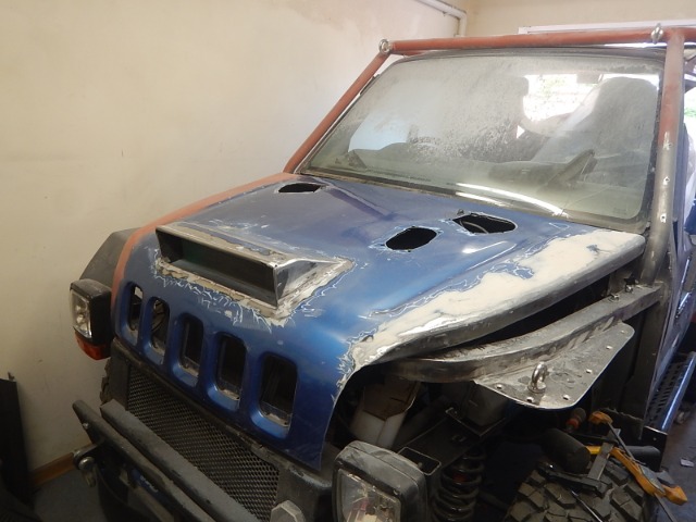

I thought I'd ease myself into the day (I always start with an easy job) by cutting the other flat steel bar that had recently arrived from eBay...
Ahh, spot the (un-)deliberate mistake?! Hmmm, how am I going to get two out of that too-short piece of 100mm flat bar?
Measure, and re-measure...
That;ll do it!
:lol:
These are for the sides of the LED light pod...
So that's room for me to weld the thin outer sheet of the bonnet skin to the 'thick' 6mm flat bar, and then round it nicely afterwards...

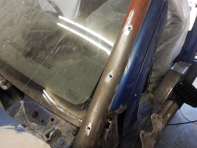

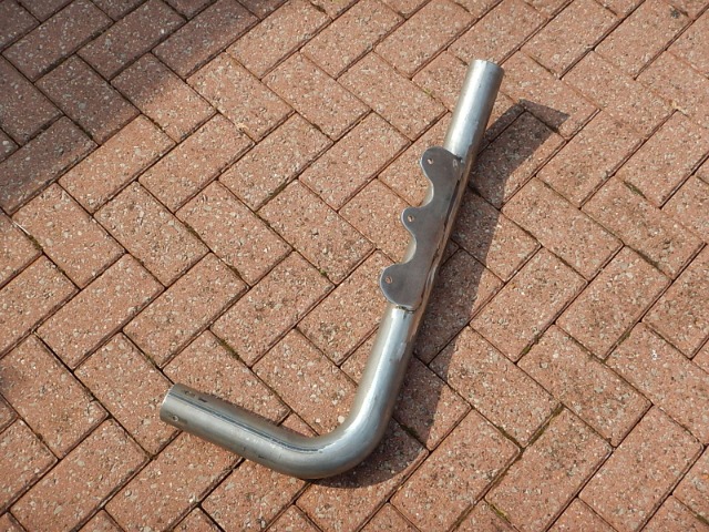

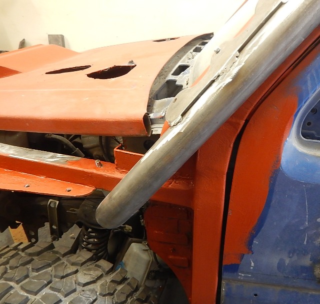

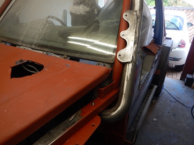

I welded the bracket that I'd whipped up on Friday to the snorkel , and then drilled and fitted rivnuts into the 'cage's A-pillar tubes, and then nipped round to the shop for a cold drink and some 8mm bolts - all my nuts and bolts are stored in the shop store room from the days of Bits4Vits... anyway, my neighbour shouted me so I crossed the road to where she lives opposite the shop... I assumed she wanted some alcohol for later, even though we weren't open... but, no, she proceeded to tell me that another customer / neighbour / friend had been found hanged overnight
So I went home to tell the missus, and sat and had a cuppa in a bit of shock...
And so returned to the garage later...

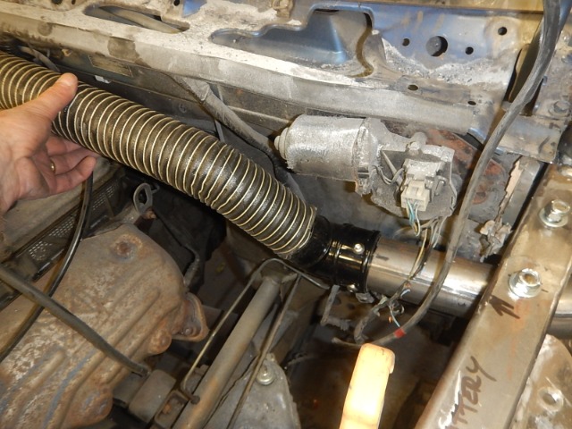

I cut the other end of the snorkel tube to the correct length and then drilled it to bolt a 45 degree bend on the end to link to the convoluted hose that will come over the top of the engine...
And then, the missus appeared... "the roller blind doesn't fit", she said, so another hour messing about with that
Ended up cutting the tube with the angle grinder, and the cloth of the roller blind to suit... but as long as the Queen is happy
:woohoo: You know how it is guys?!
I then took the snorkel tube back off, and ground and sanded it to finished quality, and took this photo of it to email to my mate who runs FloFlex Polyurethane to see if it's not too big to pop in with their usual plating, which usually consists of the insert sleeves for their polyurethane bushings...

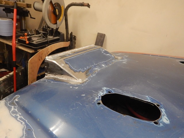

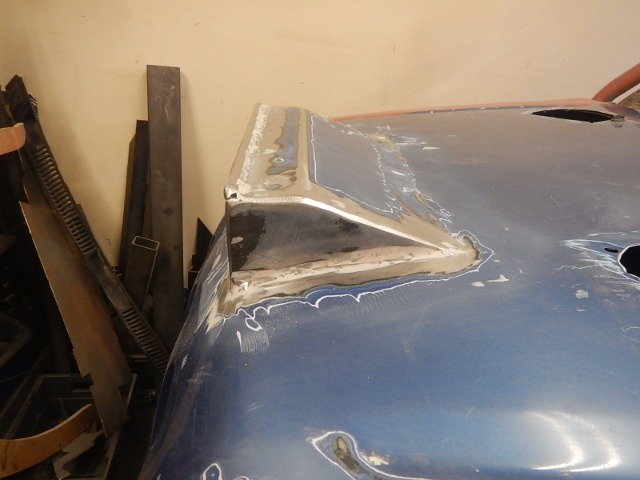

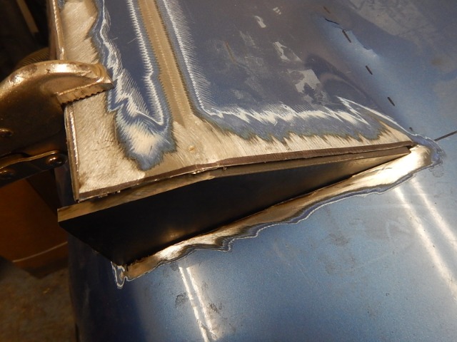

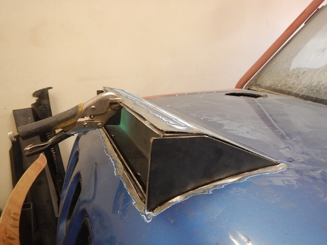

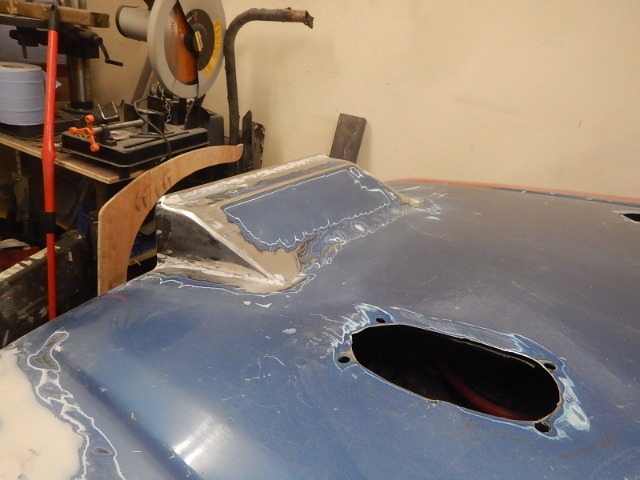

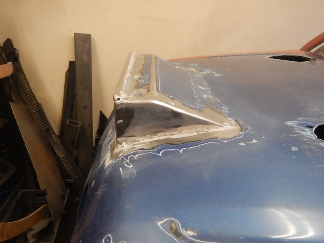

Thought I'd finish the bonnet LED light bar pod :woohoo:...
Lotsa welding, grinding, sabding, and a little bit of filler later...
Blimey! That turned out better than expected!
Lick of paint! I'm using red-oxide as a primer, and to see any flaws before the yellow agricultural enamel paint goes on for the final finish... it needs flatting down before then!
Ooops! Gravity has rotated the JCB healights, but you get the idea...

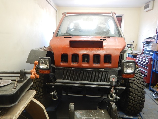

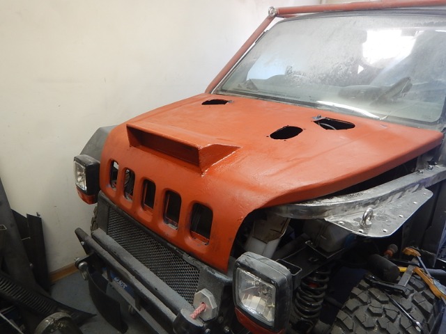

So...
I'm getting there!
The passenger door is boxed in, but needs grinding / sanding / little bit of filler / finshing...
The radiator expansion bottle / windscreen washer tank / engine battery brackets are all ready to weld up and then fit...
So that'll be all the welding and grinding noisy bits done?... just as our eldest daughter heads back down south next weekend :lol:
So we're onto finishing up?... paint, lights, etc... :woohoo:

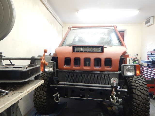

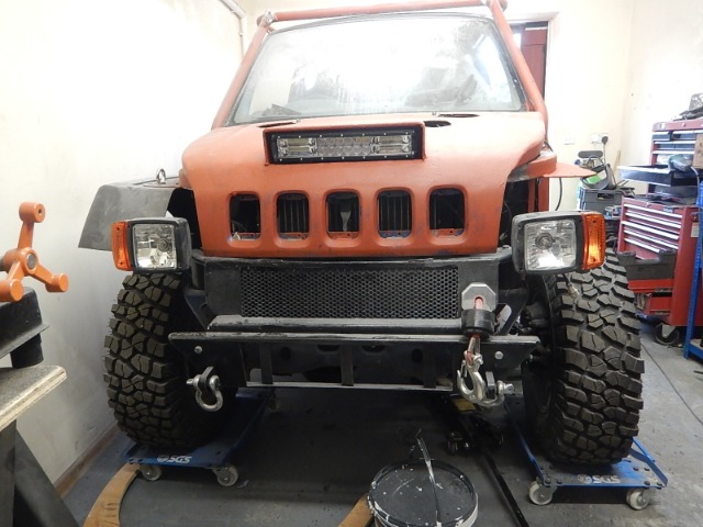

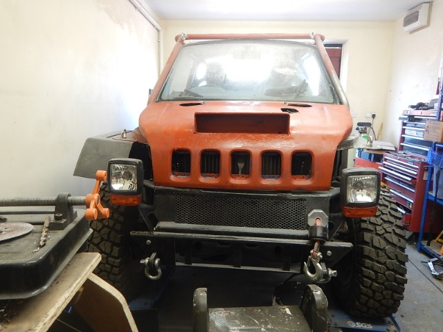

Eh? Sorry... What do you mean the bonnet photos are useless without the light bar in?...
Ah... go on then, I'll go and fit it (two minutes later
There you go
One more
I'm getting there!
There you go
One more

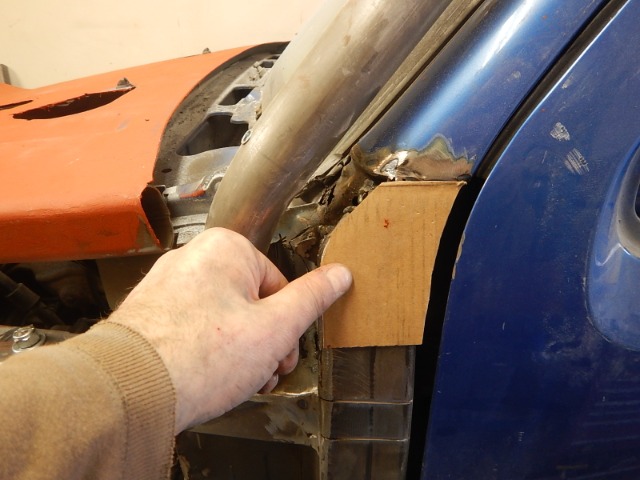

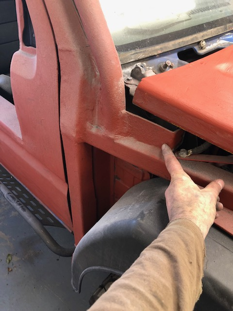

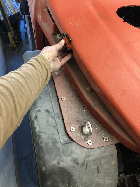

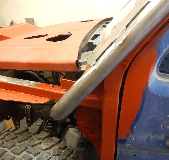

Going back to image #9867... (Sorry, we've been binge-watching "Line of Duty" :laugh: ) ...
The idea of those flat bar sections was to house the side repeaters...
You can see on the driver's side that it is clearly visible from the side -
But on the passenger side, image #1 above, it is somewhat obscured by the snorkel tube...

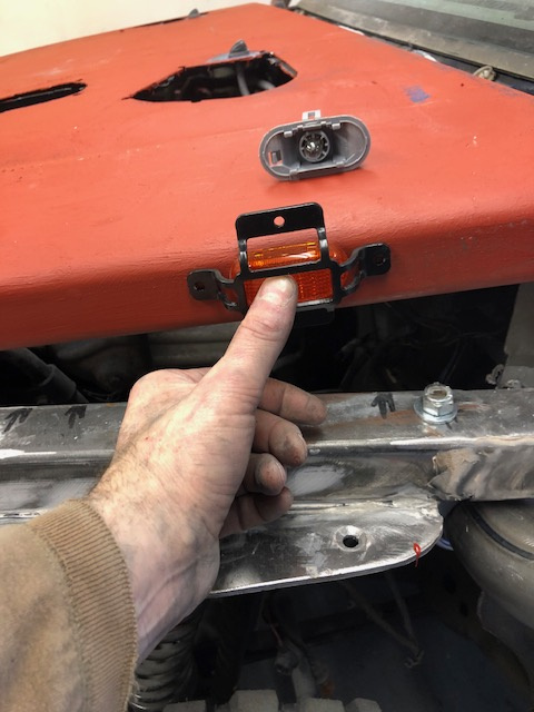

Hmmm, so... in the garage I posted on Brett's "Jimny Jaunts" Group WhatsApp asking the rest of the lads whether a side repeater was absolutely necessary (for the MOT), as the JCB headlights I am using have repeaters built into the side of them... but, double-checking them after posting, they too are obscured somewhat by the mud guards...
And then Statey ("Camo Jimny") said... "What about on the side of the bonnet"?... Genius! Hadn't thought of that...! SO...
If I was to holesaw through the oval tube that I've used to make the bonnet edges, I could fit these new / original Jimny side repeaters into the bonnet edges so that they are clearly visible from the sides, and re-use the new JimnyBits repeater guards I've already bought to protect them (from those pesky trees!) by folding the brackets around the oval tube top and bottom...
And bearing in mind their placement here above the mud guards, with their own guards they should be safe on the edges of the bonnet
I think I owe Statey a breakfast / Pint!
