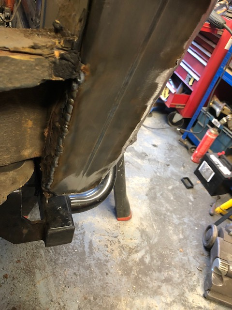

The original pull rod is still there you can just see it inside the door skin...
I've cut the door skin to get it out and will mount it below the lower part of the door through the new aluminium chequer plate 'door card', it still works fie at that angle...

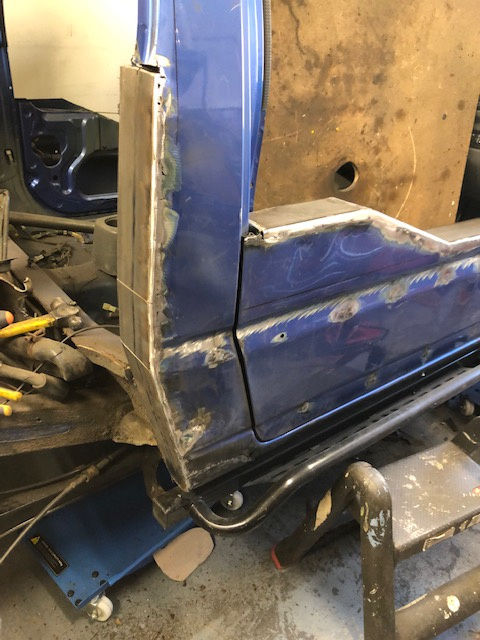

So today I planned to fill in the rear driver's side of the cab...

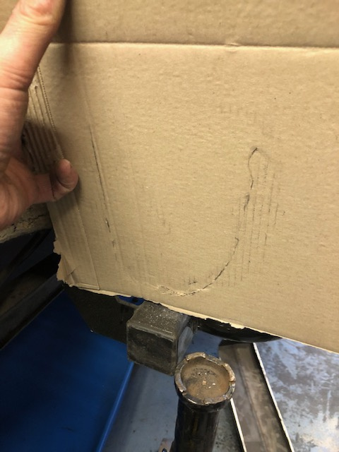

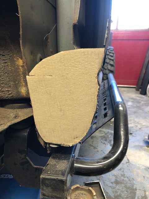

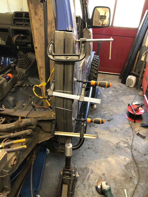

This is the other half of the 4"x2" (100mm x 50mm) rectangular box section that was used to cap the top of the half-door... you can see it has the seam down the middle of it, but no matter as most of it won't be seem anyway as it will be obscured by the rear lorry wheel arch...

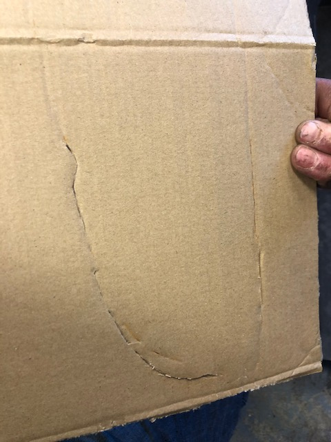

The easiest way to copy a panel shape,, cardboard and a hammer! Simply tap all around the edge...
And there's the outline on the other side, cut out with scissors...
And there's our profile!

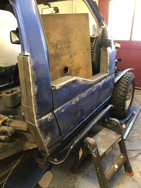

Box section cut and manipulated to shape...
And welded in place, as much as I could before the welding gas ran out
Taking shape though!
I managed to get the outside done, round the sill and back up to the floor, so there's just the inside to do, and some corrections to be applied to the outer skin... grinding back shows where I've missed a little bit here and there... :blush:

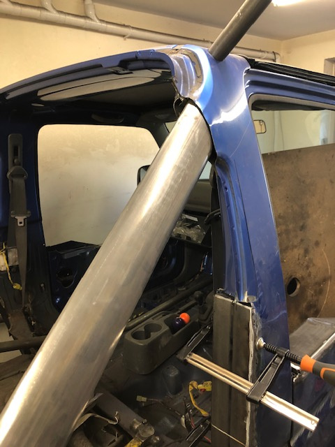

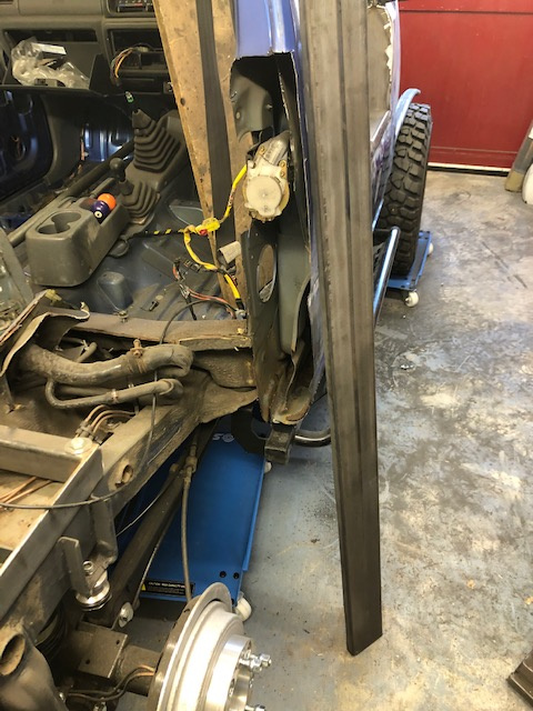

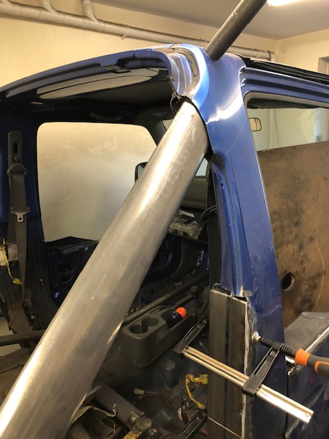

Quick play... this is the oval tube that will be used to form the back support... it will look slightly like the original shape of the Jimny soft-top but also a hint to the EX Ford Concept Buggy I've admired for may years -
You can hopefully get an idea from that what the back of the buggy will eventually look like... sort of based on that... but with the front and mid section based more on the yellow buggy -
Also in the last photo you can see the beginnings of the X seamless tube strengthening for the roll-bar's structure, poking through the outer skin is a smaller diameter piece of seamless tube, this will be plug welded into the bigger 50mm X bracing and will come through to hold the roofline's tree scraping bars similar to my old blue Jimny...

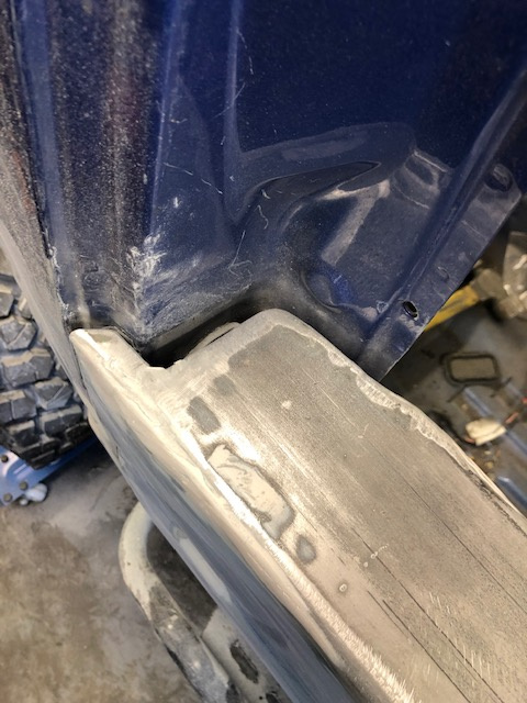

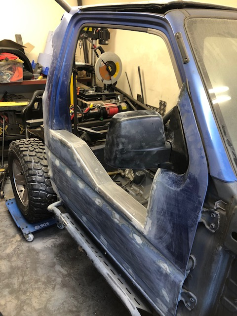

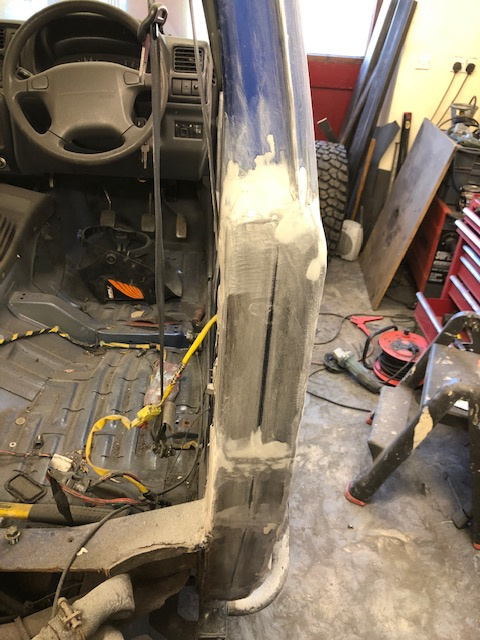

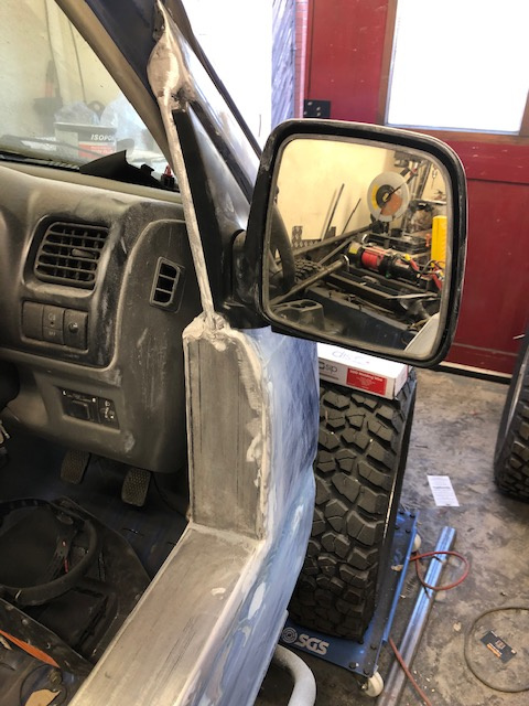

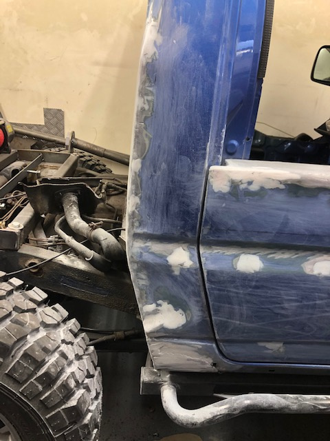

Finished welding up, and then sanding down and some body filler to make it all look nice, including blending the top of the fill-in piece back to the main 'hoop' of the soft-top body...
Ends up looking nice, an even gap on the lower panel where it kinks in slightly, following the line of the bottom of the door...
The door has all been fillered and smoothed back too...
Including the improvements to the door jam area
And I blanked off the top of the cutoff door above the mirror, where the window channel has been filled with tube...

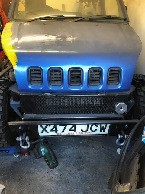

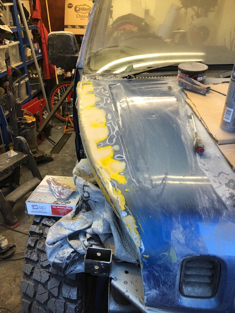

Being as the filler was out, I also fixed the welding warps in the outer skin of the bonnet and then work down the grades of sandpaper until final finishing with 'wet-n-dry'...
Some red-oxide primer should arrive early next week to paint it all and stand back and check it all once again...
