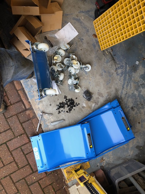

I might be 52 and a bit, but this past week I ordered some dollies :woohoo:

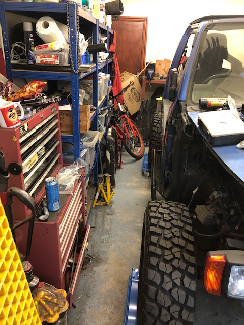

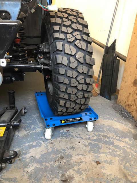

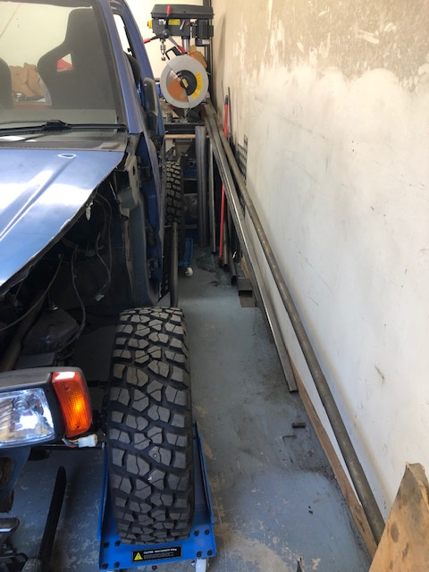

Only trouble was that they came needing assembly! 16 castor wheels to bolt on! So after a lie-in, walked the dogs, and a cooked brekkie (of course!) I started tidying the garage after the blue Jimny had been hastily emptied as it sold quicker than I thought, and the dollies were eventually assembled...
One per wheel!

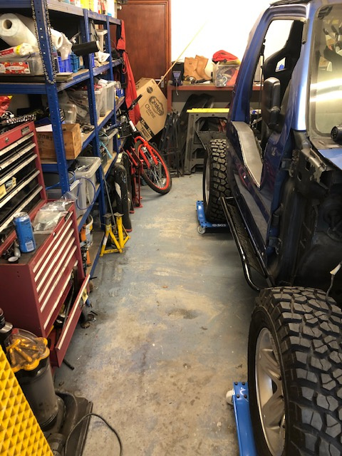

So on the passenger side there's a fair gap to the wall...

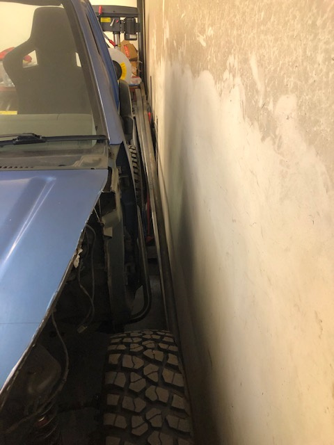

And on my side there's enough of a gap to pass...

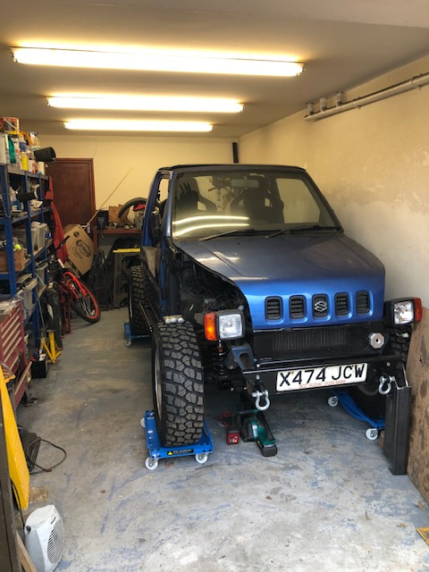

With all the dollies under the wheels the buggy can be pushed around to suit...
Leaving loads of room to fettle, shape, weld...
That done, time for a cuppa!
There you go, pushed to one side to make access to one side or the other much easier!

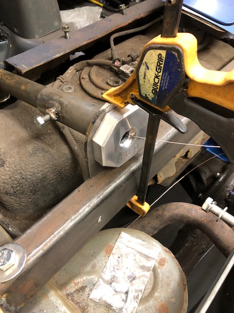

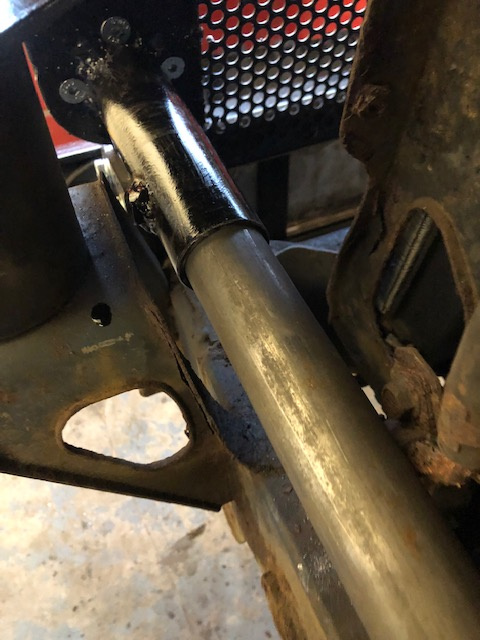

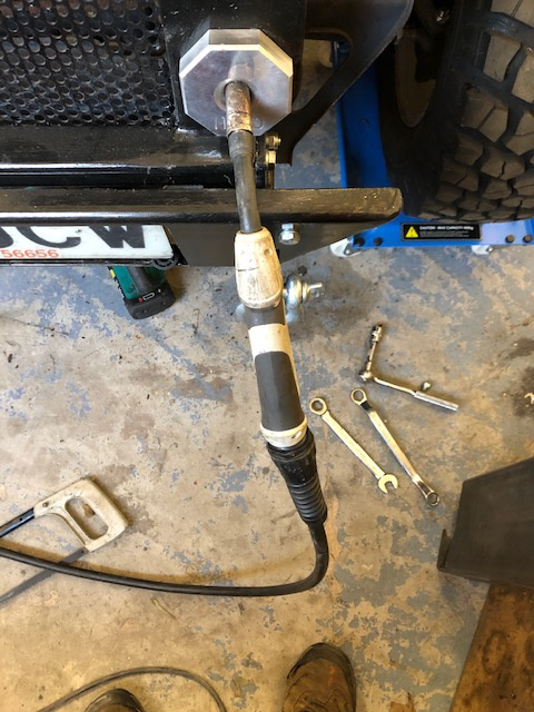

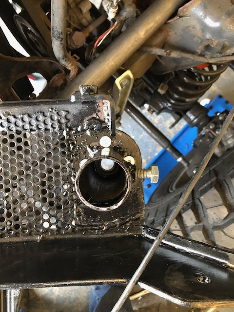

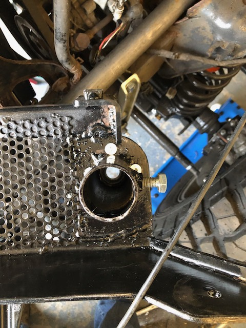

I disassembled the front grill, cut a sleeve joing for the winch tube and welded it in place/// with just enough room to bolt the dont fairlead in place!
With he MIG welder out, I took the earth clamp off, and used the wand to run some MIG wire through the tube ready to pull the rope through later... from front to back...
Another sleeve was made for the rear of the tube... note the 10mm bolt to clamp the inner tube inside the outer tube
Back to the front and you can see the same on the front end of the tube...

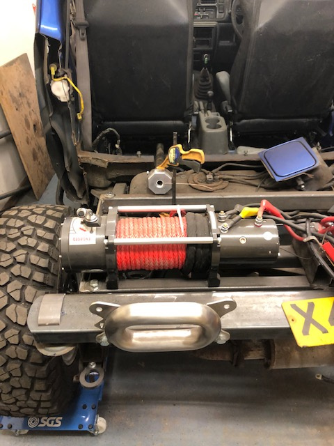

As a reminder... the winch is on the back of the buggy, the rope always runs to the front of the buggy through the seamless tube that runs under the passenger (Alan's
) seat and along the chassis rail next to the engine and out the front through a matching donut fairlead... To winch forward you use the winch conventionally even though it is situated at the back... to winch backwards, you simply pull a loop off the drum through that mahoosive fairlead and insert a snatch block (roller) in the loop that was pulled through.... Later they'll be another fairlead on the back of the roofline so in the same way a loop can be pulled off the front of the winch and threaded through the fairlead for self-righting or to stabilise the buggy on side slopes, etc...

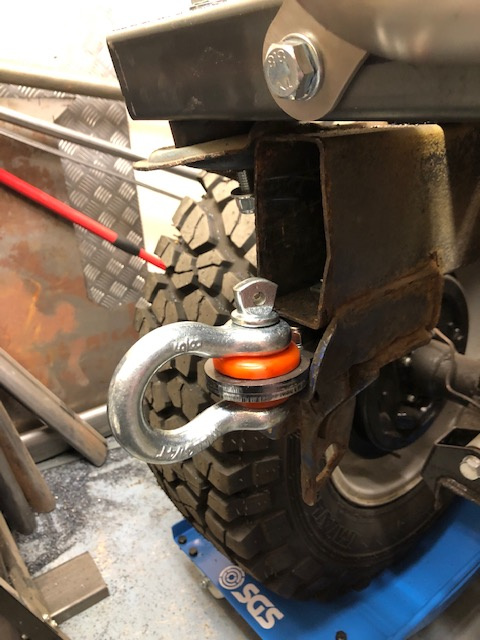

I finished the day by messing about with the rear recovery points...
These were made from some ARB disconnect brackets featured earlier in this build thread, I've now added some poly bushes that were angle-grinded with a sanding disk to suit, and stop the shackles rattling around...
