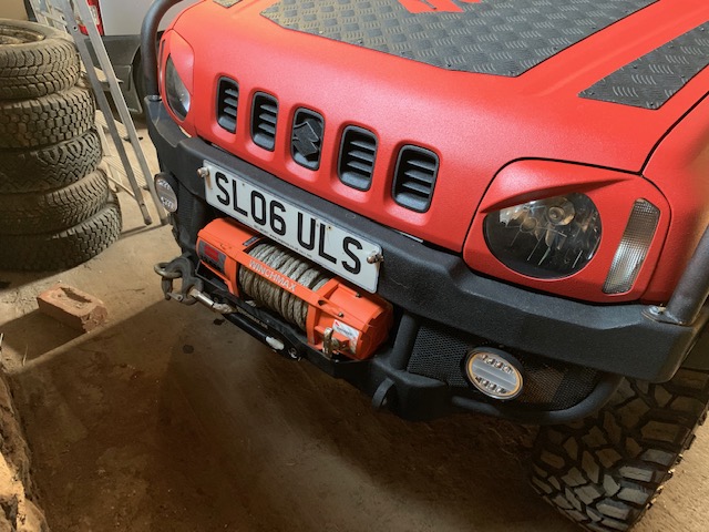

Stripped the winch, steering damper and airline socket from J999MNY and started fiddling about getting them onto Ulysses. All went on fairly easily and are working well. Bled the brakes again also as they were still a bit spongy.

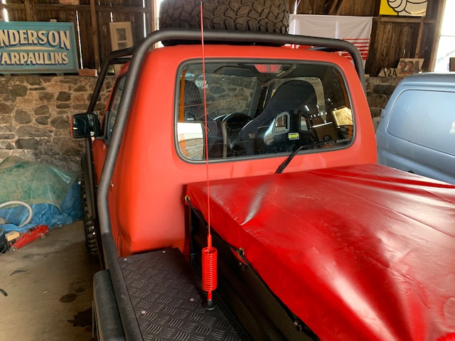

Courier dropped of the all important final parcel with the CB and aerial in mid afternoon so had time to get that stuck on and working/tested. Aerial on the rear mud guard to keep the twanging noises down inside the cab!

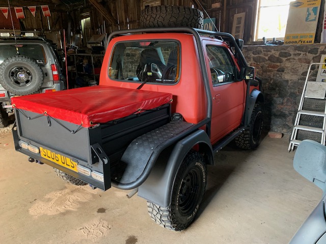

then a bit of packing of spares, tools and sundries (loo roll) into the space avaliable. Amazing how much room there is behind the seats. Got all the tools, high lift jack, recovery gear, fridge and various clothing/boots behind the seats easily. Big box of random spares and a socket set in the load bed and strapped down as well. I had expected problems trying to pack all the gear in, but theres none of that. Room to spare in fact
