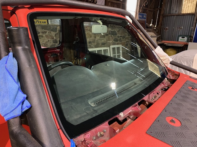

Today however the windscreen man turned up to sort the cracked and chipped one in Ulysses. With the body shape flexing and changing slightly the screen had taken a turn for the worse. This guy, Martin, was recomended by the garage landlord so gave him a call. Quoted £110 fitted so ordered up on monday, fitted today. Great service and really good price as well.

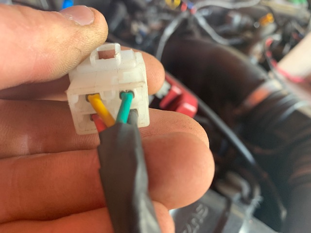

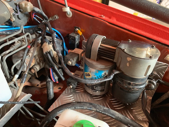

Got the resistors fitted first for the back lights and thats solved the problem well. Next onto the compressor and switches. Had a fight getting this large plug for the switch wiring through the firewall so took it apart and went in easy.
Wires ran back to where the screenwash bottle used to be and connected up to the compressor. Bit of head scratching as to which wire was for what, but figured it out with the help of good old google :laugh:

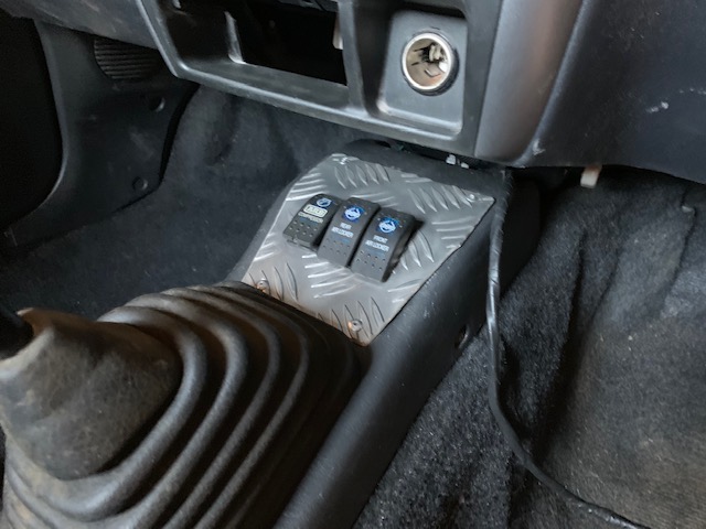

Then made a small plate to cover the area below the ash tray for the switches. works ok, but doesnt look the best. Needs Raptor painted! test run and its working ok, except the switch for the compressor is operating the other way up to the others so need to swap that around tomorrow. Compressor is a much older model than the one in J999MNY, but works fine. Is a lot more noisy tho...

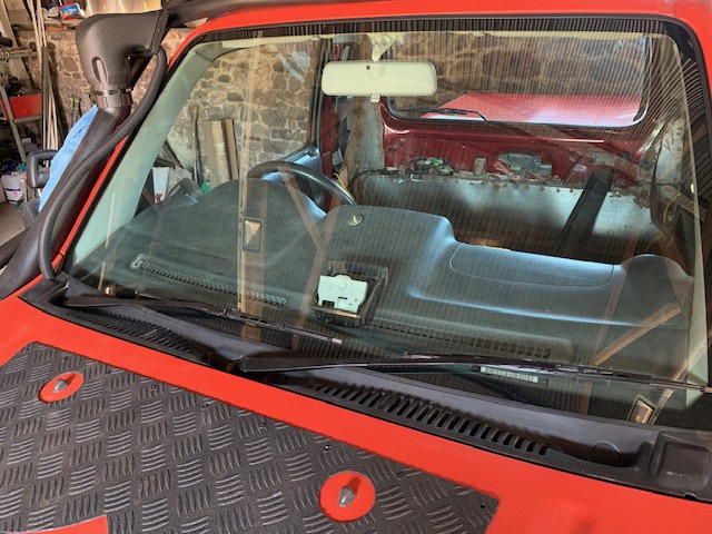

Finally put the panel on below the windscreen and all the wipers back. looking nearer to finished now. The black pipe near the snorkel is for the diff/gbox/tbox breathers and loops back into the snorkel head. Need to fix it back somehow.
