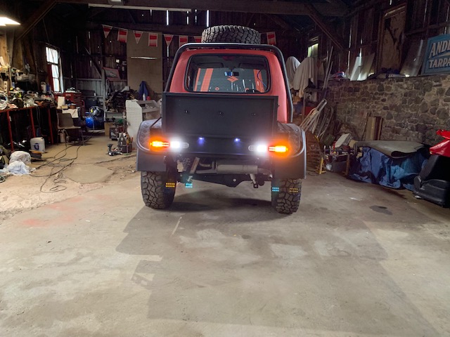

29 Jun 2019 16:42 #210431
Thanks all for the kind words

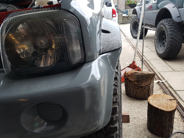

I would be very interested in some of the arches you mention Keith, they look like they would fit perfectly. Ive had to cut bits out of these ones to make them sort of fit as they are lower at the front than the edge of the wing.

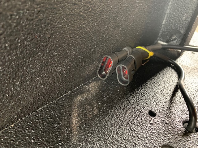

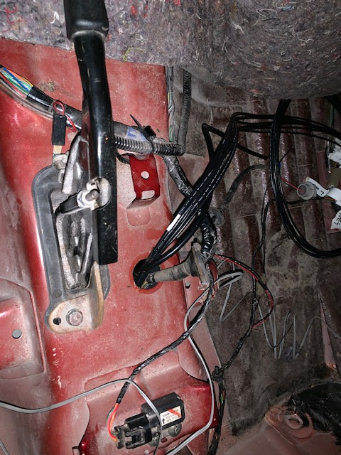

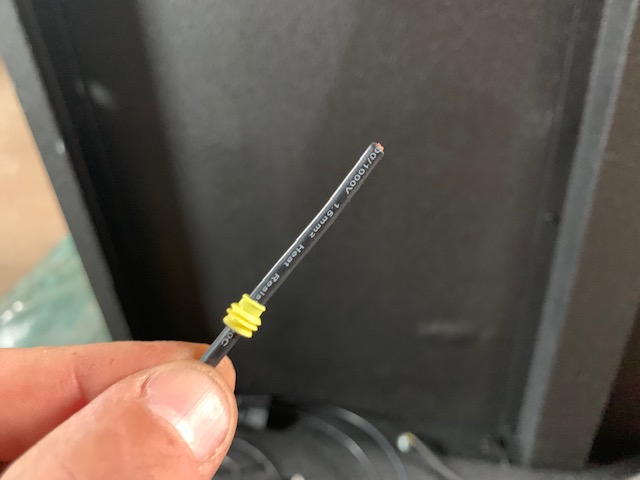

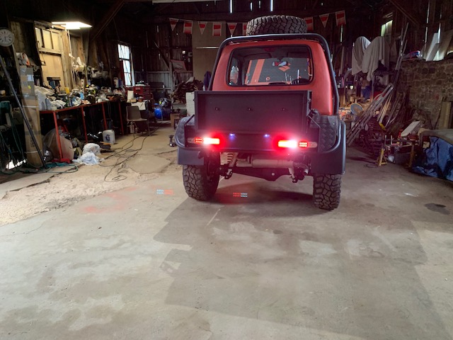

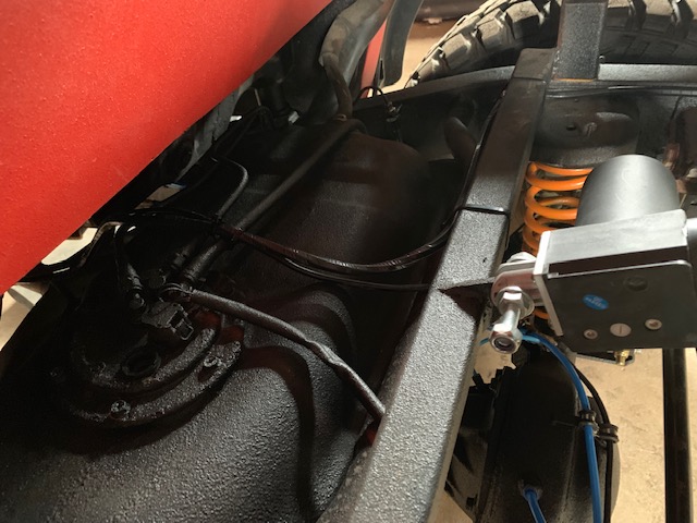

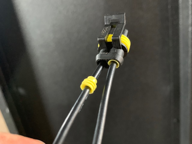

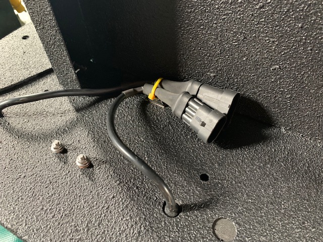

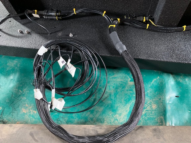

Day of wires today. Back lights specifically. Made up a new harness with some neat plugs and fed it in through the cable grommet beside the handbrake...

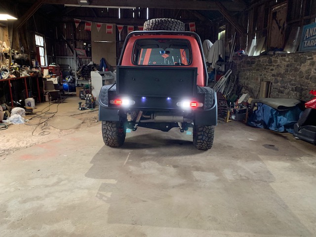

Connected up and nice and bright. The indicators are flashing like there is a bulb blown, so some sort of dummy load is needed to sort that I think. Work normally when on the hazard button, just not individually
29 Jun 2019 17:11 #210434
by RainerK
Replied by RainerK on topic Re:Ulysses
Or you get an load independent indicator relay. They are quite cheap out of China.
