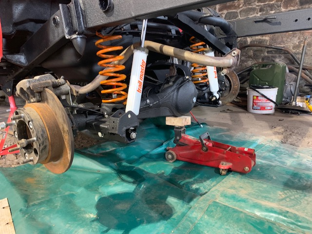

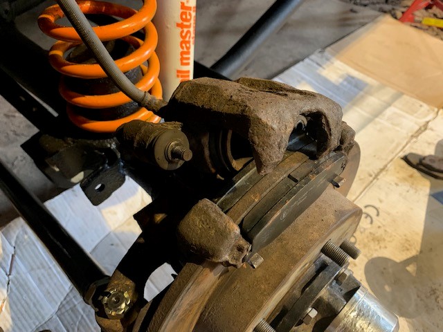

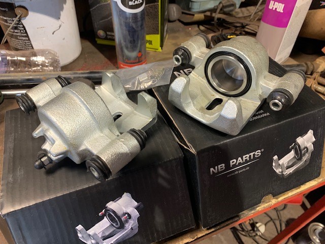

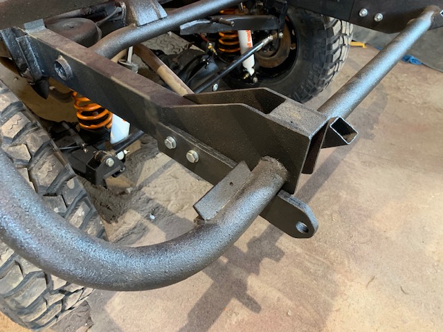

Repainted and stickered Trailmaster shocks/springs and brand new Trailgear HD steering bars on. Then problems with the old brake calipers. Had forseen this so ordered some from ebay coming from germany (a new pair for £96.69). To fit tomorrow...

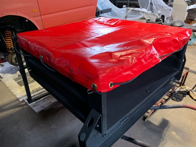

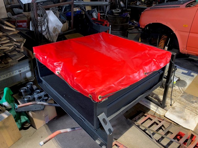

And finally... My garage landlord has a side business with wagon tapaulin supply and repair. He got this made for the rear bed for me. The red is a bit bright, but it will look the part hopefully...

I'm liking the tonnau colour good strong red that!

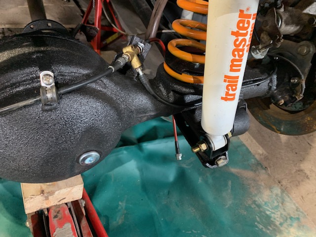

Back at the spanners again today. Got the new brake calipers on the front and new braided, extended and red lines on. Think I need to nip it up as it was weeping a bit on the connections to the old pipes (and bleed it all). Forgot a picture of that though :laugh:
Onto sorting out the rear then.

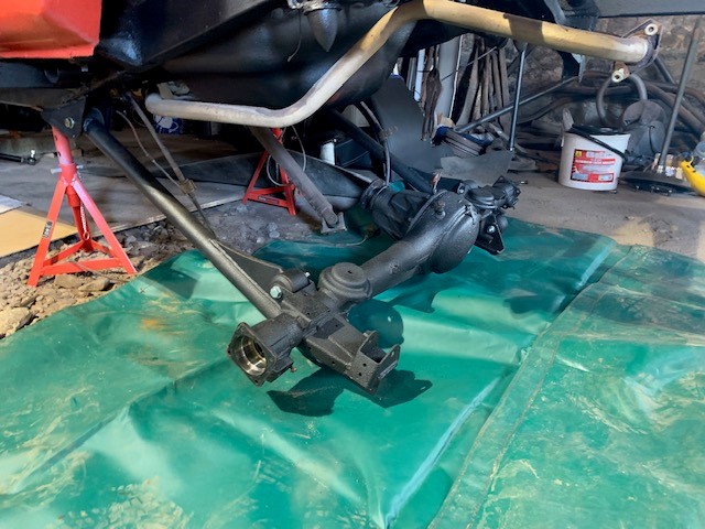

Trimmed the old brake drum back plates off the rear shafts and cleaned them up. Popped back in a treat. Springs and shocks also nice and easy. Then the rear disc conversion kit out of the stash and onto the axle. Full braided hoses on as well and some nice stainless 'P' clips to hold the cross-axle pipe on securely.

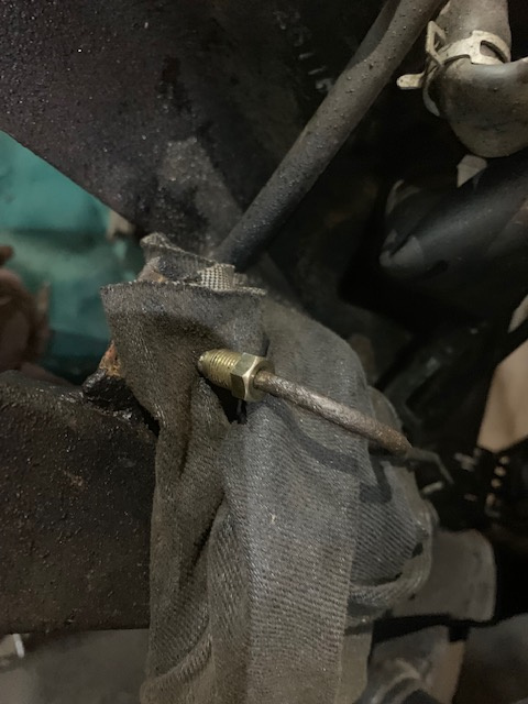

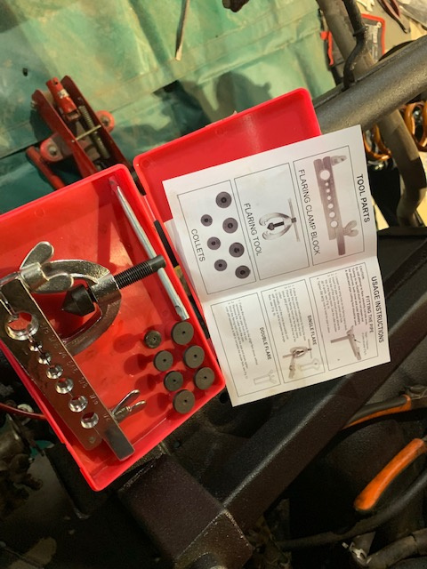

Then the brake union on the chassis was rounded
so it got cut off and a nice new flare made with this tool...
Also had a problem with a cold welded nut in the bush of the panhard rod so fished that out, spare one in and welded the adjuster (once adjusted) to stop any future problems.

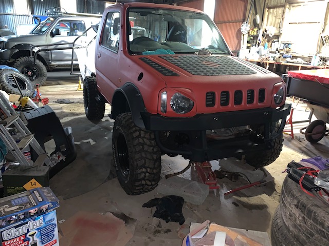

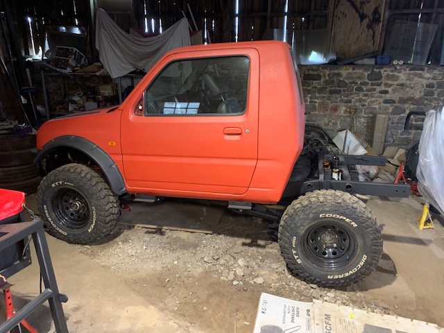

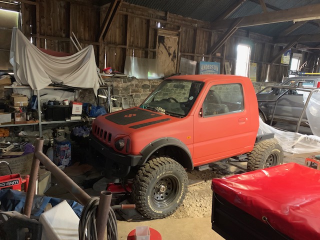

Then it was wheels back on and down to the ground time. Front wings bolted down and front bumper fitted. Wheel arch plastics fitted also. Coming along nice. Cage and pickup body next time...

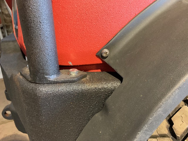

22 Jun 2019 16:38 #210207

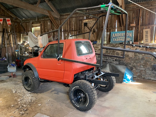

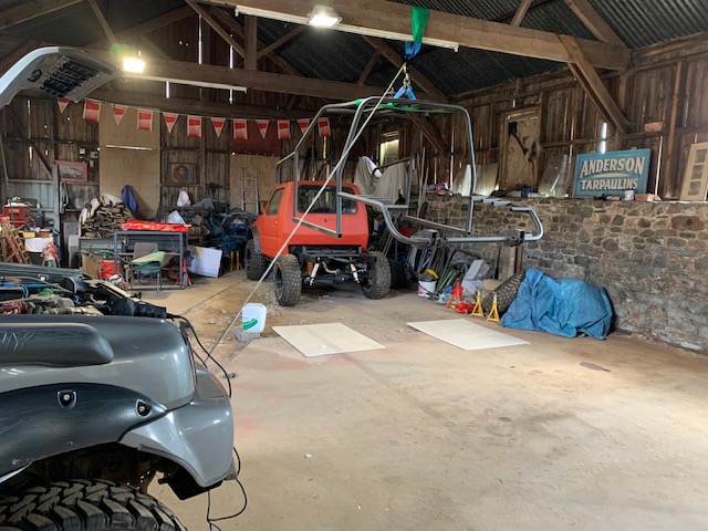

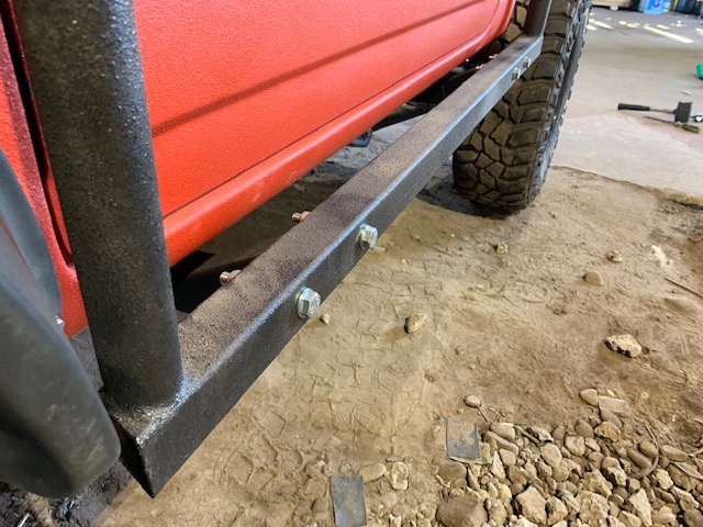

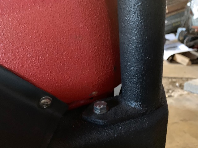

Cage back onto the body. Winch out again on J999MNY (about the only use it gets :laugh: )...

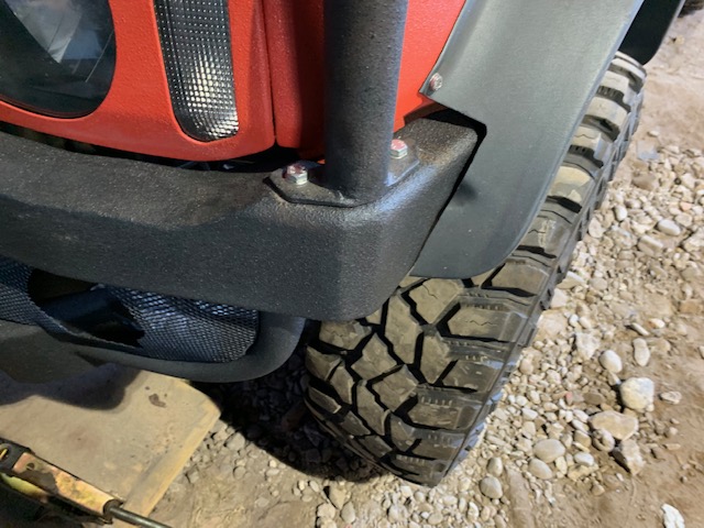

and bolted down again with nice new fixings and locknuts everywhere...
but managed to scratch the paint on both front wings, because I was doing this on my own...
just as well I have a spare bottle of the red then :laugh:
continued...
continued...
