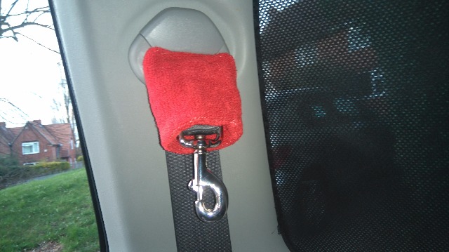

I like that Jack, need something similar, but need to keep the rear seatbelts too... not sure my daughters would like being clipped in
:lol:
Replied by X8GGY on topic Re:Dave's Gold (Beige!) Daily Driver
jackonlyjack wrote: I have no rear seats
This was my solution Dave
Harness and modified rear belts
Works a treat
Jack

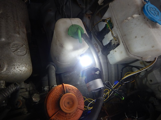

So onto the headlight bulbs...

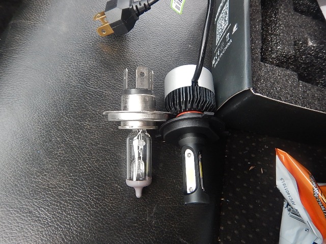

Hmmm, bit of a size difference?! There's a little cooling fan on the back of the new ones...
Thought I'd better try them before assembling everything... Yup! Them's bright alright! :lol:

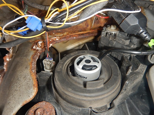

I cut around the fan housing in the rubber gaitor that fits around the back of the headlight..
Yup! them's is bright... have to go out and test them soon!

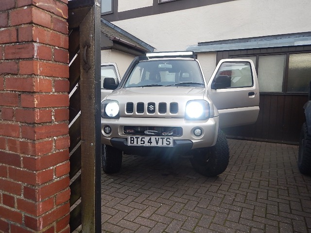

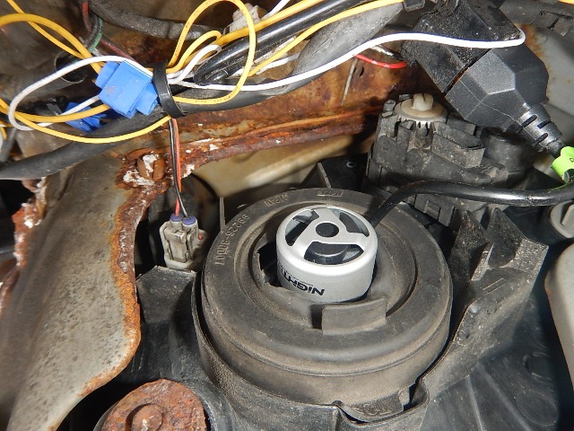

Replied by MadsV on topic Dave's Gold (Beige!) Daily Driver
Did you check the lights if the lines are correct? In my experience any other than standard bulbs make a shitty pattern in these reflectors
