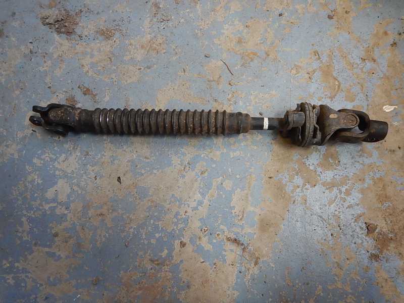

The steering spacers arrived this morning, usual excellent service from Rus and the gang at JimnyBits -
Angle grinder, vice, punch, hammer, swearing, spanners...and a few minutes later...
:laugh:
And then a quick spray of paint to tidy it all up and detract from the eye of the yearly inspection man! :whistle:
As I say, lots more in the blog if you want to have a read...
Dave

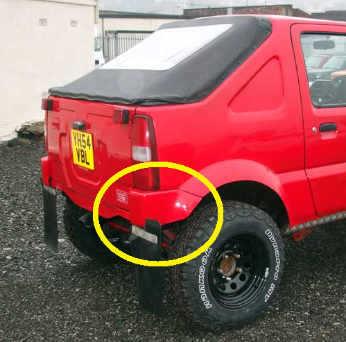

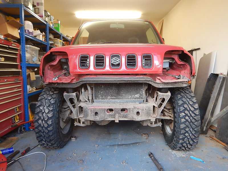

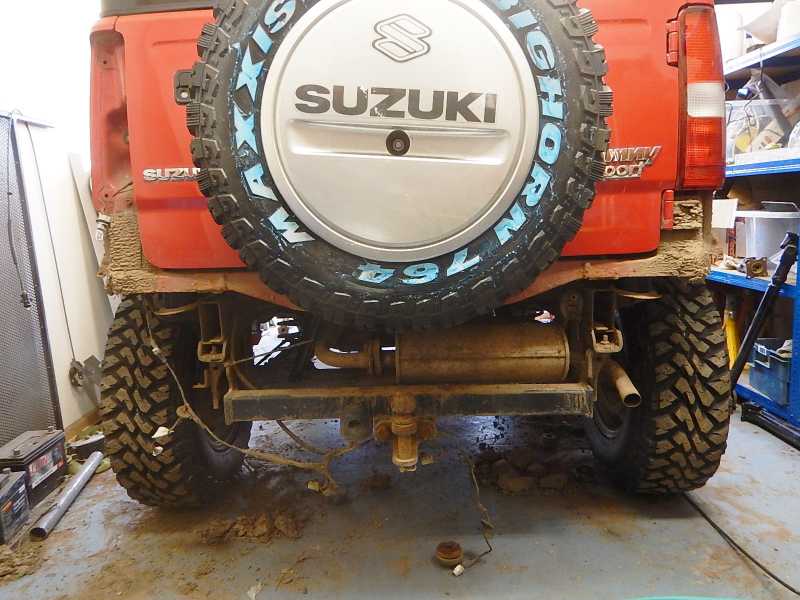

I mentioned in the blog that one of the consequences of bodylifting a vehicle is having to raise the bumpers up to match the height of the repositioned body, as the bumpers are attached to the chassis...
Not a problem on my new build though, as new "bumpers" are going on...
A quick call to Darren at KAP - www.kapsuzuki4x4.co.uk / 01535 610840 and a front trim panel and rear corner trim panels are due to arrive next week...
These will also add to the minimal lift, by making it appear taller, and getting rid of the old bumpers that would have fouled on the big tyres, and made the Jim' look lower...
