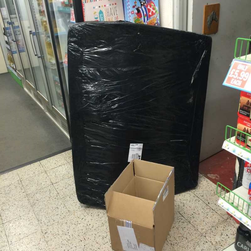

24/04/16 - another parcel arrived this week...
A big one!
A rear fibreglass hardtop section...!
The rear hood on the Jimny wasn't in too bad a condition, but they never seem to fasten right onto the tailgate, and leave the Jimny with little or no security, so I thought this time I'd go for the...
Fastback look!
Just needs the brackets fitting to attach it properly... And a window fitting into the sloping part of it, which I'll order this coming week...
If you fancy a rear hood section like this they are available from IdiotMobil on this forum!
A couple of bits arrived from JimnyBits this week too, on the left is a brake compensator bracket for the rear axle, and on the right a single stud extender from the Grayston wheel spacers...
That fits onto the spare wheel bracket here...
...and allows the spare wheel cover to be refitted (to hide the spare steel wheel underneath!)

The BadBoy (eBay again) Bucket Seats that were destined for the buggy will be going in this red Jimny too...
And some other bits... but more on them later...
To correct the gearing after the 235/75/15's have been fitted, there's a Rockwatt Rocklobster Transfer Box, Cradle, Speedo Drive Cog and intermediary prop on the way, from Rockwatt. and I've sourced a Samurai front prop to use on the rear from eBay.
