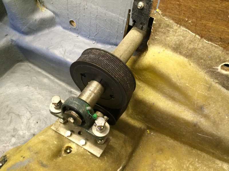

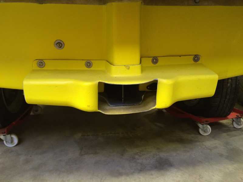

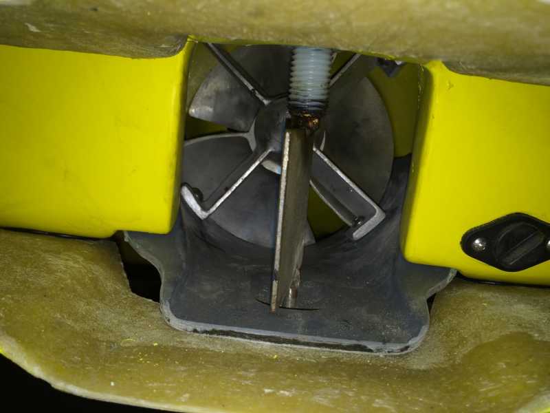

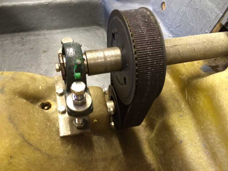

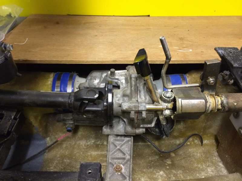

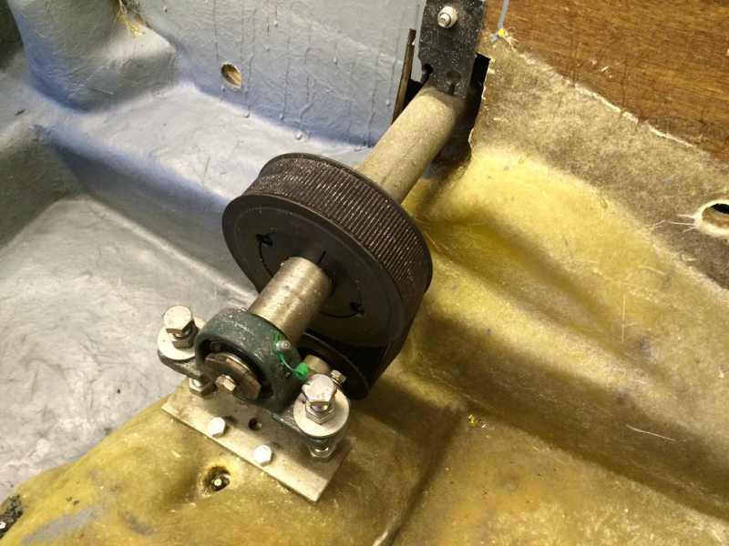

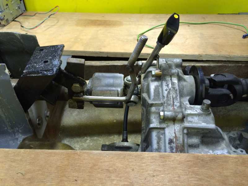

As requested and again apologies about the late reply, here are a few pics of the jet drive system...
Electronic transfer case converted to manual shift, with additional PTO and dog leg clutch feeding power to the rear PTO/jet drive shaft
View of the manual shift
The belt drive system taking power from the PTO on the transfercase to the jet drive
Close up of the 8" impeller and rudder that is connected to the steering via a morse cable
Rear view of the Surf showing the impeller/rudder assembly and side thrusters (It will turn on the spot in the water)
