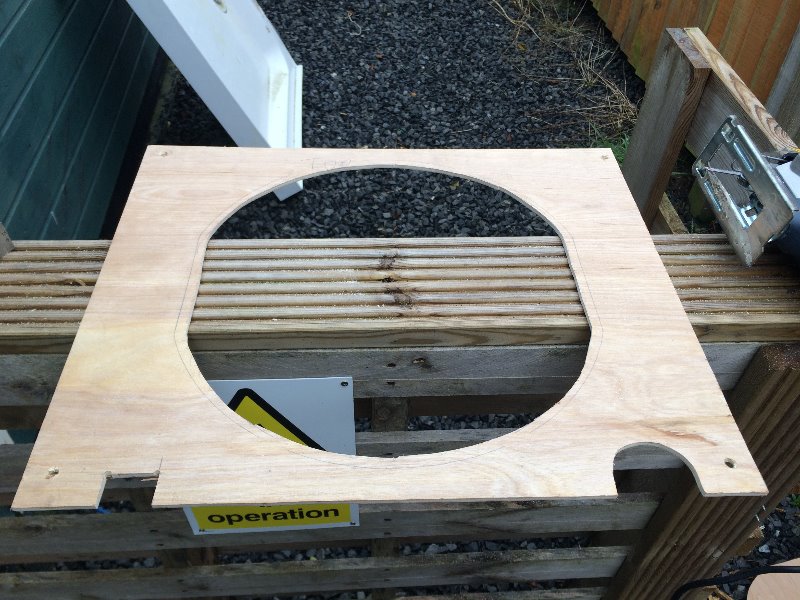

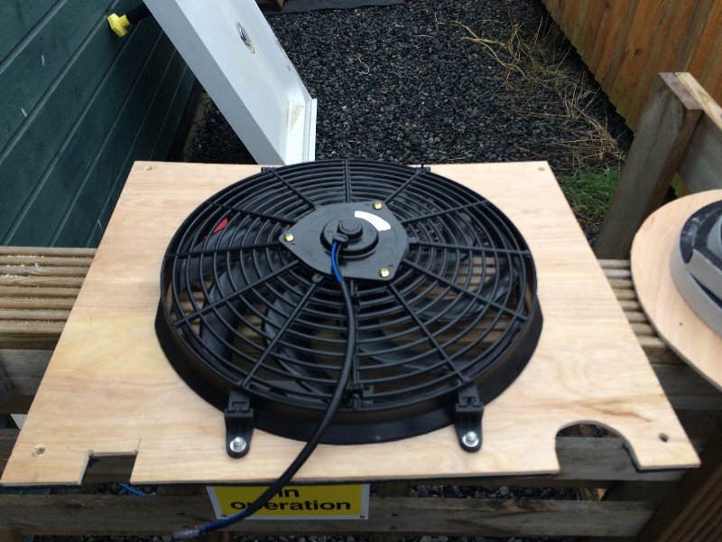

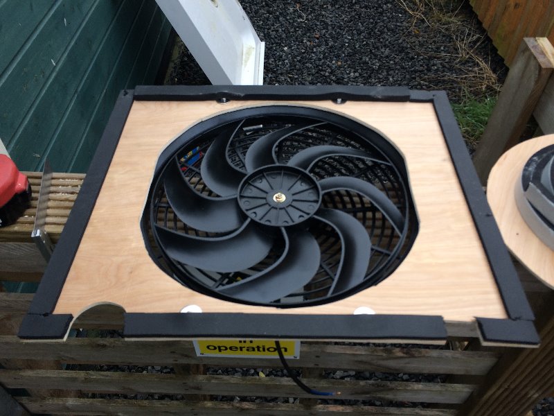

Few photos of the 16" electric fan shroud and mount to replace the mechanical fan. A simple set up using some 5mm ply wood and self adhesive foam strip to ensure a complete seal around the radiator.
The fan is wired to run at all times when the engine is running to keep both the engine and engine bay cool.

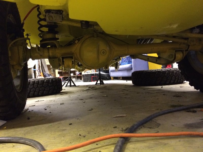

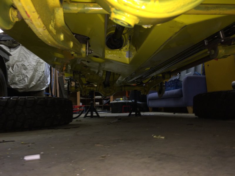

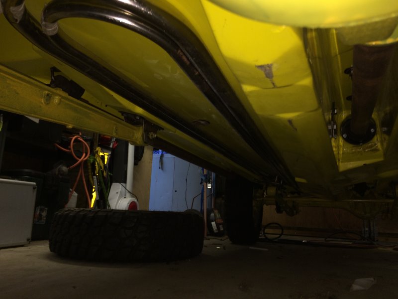

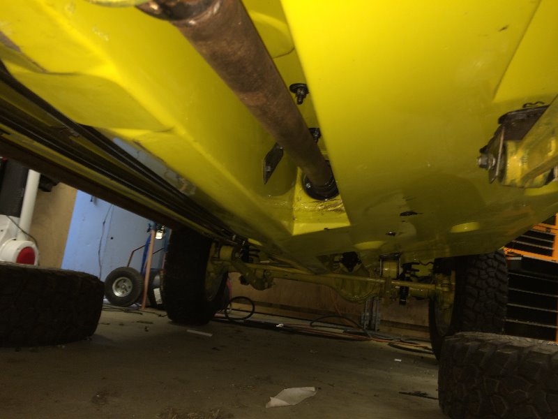

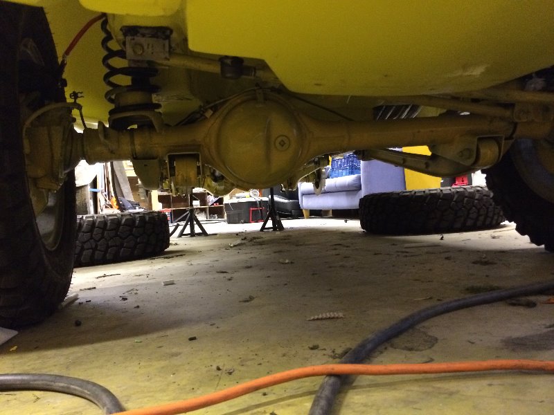

Some cheeky bottom pictures as requested! Let me know if there is anything particular you want a good look at :woohoo:
Photo from the front looking towards the back
2nd photo from the front looking towards the back showing front prop shaft and the oil and water heat exchanger pipes (stainless steel pipes running on the right hand side of the hull)
Close up of the rear prop shaft and the oil and water heat exchanger pipes
Final shot from the rear looking towards the bow

V-350 wrote: Awesome build!! Can you make some pictures from under the vehicle please?

I was never quite sure why the fan is always on. If you've cooled the radiator you've probably cooled the engine bay, haven't you? The problem being is that if you leave the ignition on for any time, perhaps to listen to the radio whilst parked, the battery goes flat.

Many thanks for the bottom pictures!! Make sure you get the many holes for various bolts watertight
Keep up the good work, and please keep us posted with pictures!!
