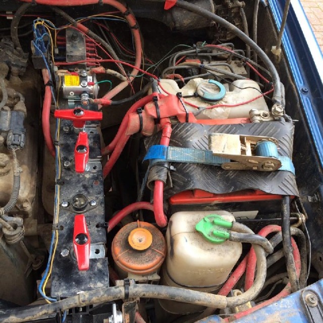

On the last few trips I've had electrical problems
I'd replaced the ARB Compressor and the Odyssey PC1200 Winch and auxillary Battery, only to find that it was the T-Max Solenoid on the Split Charge system that had gone... So I sold the new ARB Compressor, taking a small loss on it, and then...
Ordered and replaced the T-Max Solenoid, the new ones ticks over nice and loud and proud
Refitted the Odyssey PC Battery
Replaced the three isolator switches, they were the cheap ones with the red keys, they are now still reasonable but fully sealed T-bar switches
(Top one is the manual battery link switch in the off position, the other two are the front and rear winch isolator switches - on in the photo)

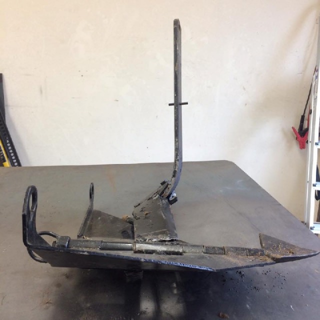

I then turned my attention to the ground anchor -

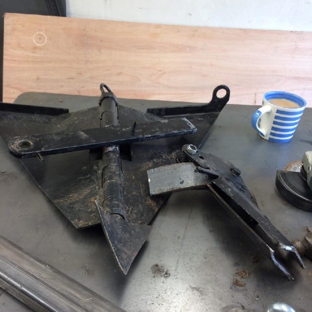

Which, after having a stricken Land Rover Discovery hanging off it was well and truly twisted, and the welds had cracked
I'd originally asked a mate to take it into work and straighten it with some heat, but looking at it again I thought it was beyond repair... So I cut off the straight bits...

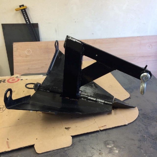

And welded new parts on where necessary... the arm is 30x80mm box with the 15mm original bracket welded into it... and then I welded 6x70mm plate over the top of the box so that it extended over the box underneath and welded it to both the middle of the spade's "hinge" and onto the 15mm handle bit...
Strong enough for a Jimny, but I won't be volunteering it's use for a Disco' again
All hammerited black and ready to go back behind my driver's seat...
I just want to add a piece of chain between the top two corners of the spade to strengthen it up when it's folded out...
