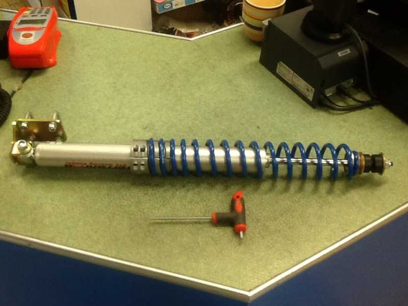

And... I've been looking at these for a while thinking it would help -
A nice big TerraFirma damper meant for a Land Rover Discovery 1 (that's what I've got fitted now) but with a self centering helper spring on it too... It's a pin and ring damper, but it comes with the mounts to mount the ring end to the steering bars, so it will fit my Jimny, and will be the same length as my existing one, so I know (?!) it's going to fit alright... and I'm hoping the additional spring will help with the size, weight and height of my Jimny and it's 31"s... As the damper is meant for a Disco' (and Defender without the additional bracketry).
I'll let you know when it's fitted how I get on...

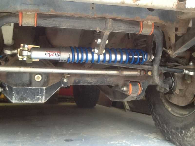

Looks like a great mud and grass collector
My only gripe about these "Steering Dampers" is that you have to undo them to align the Steering Wheel adjustment!!
