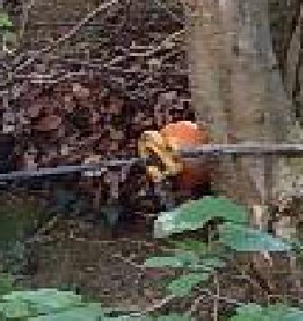

Using your winch rope like that... It wont last very long.
Always use a winch strap of some sort. Both for the sake of the trees and because you're reducing the breaking load of the rope by roughly 50% using it like that, directly around a tree trunk.

Jimny-Dave wrote: On my last solo wander (a Tuesday Trundle rather than a Wendesday Wander) -
www.bits4vits.co.uk/store/tuesday-trundl...again-/blog_319.html
...my front vacuum operated hubs failed leaving me stranded on a greenlane I was investigating and exploring, and I had to ...
... winch myself back up a slope using four winch pulls off four handy trees... :evil:
So, when I eventually got home :blush: I started investigating...
The 4WD light comes on, but the hubs don't "clunk" into place
I had a good look underneath and can't see any of the vacuum hoses damaged, although I had driven over a good few fallen branches and logs earlier on the wander...
But, with a group 'laning day looming on the following Sunday, and my family about to leave on holiday to Greece, I decided a repair would take to long to find and effect, so I reached into...
... the spares box in the back of the Jimny (the other box is full of tools), and pulled out...
A pair of Jimny specific free wheel hubs that I got from JimnyBits, and kept them in the back... just in case!
So, off comes the wheel...
And then the original vacuum operated hub...
And then the base of the new switchable hub goes on...
Then a small No.10 Torx bit is needed...
To attach the cap on...
All done, and ready for a day out with the lads on Sunday!

Yup, very true Tom, well spotted...
And my quick-strop was behind the passenger seat :blush:
Should have stepped back and thought about it some more, paniced a bit being on my own?...
