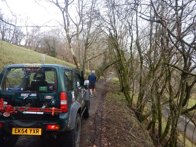

A fallen branch..
And we soon cleared the byway with some good teamwork and my cordless chainsaw "Buzz" ;)
