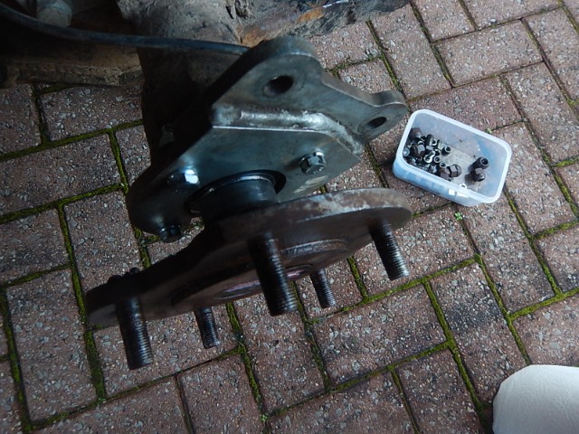

All stripped and shafts out...
And just as I took them into the garage it started spitting... perfect timing!

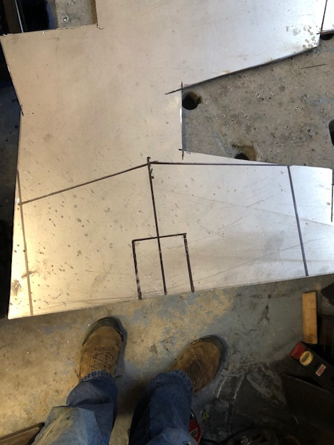

I drew a tool,,,
Cut it out...

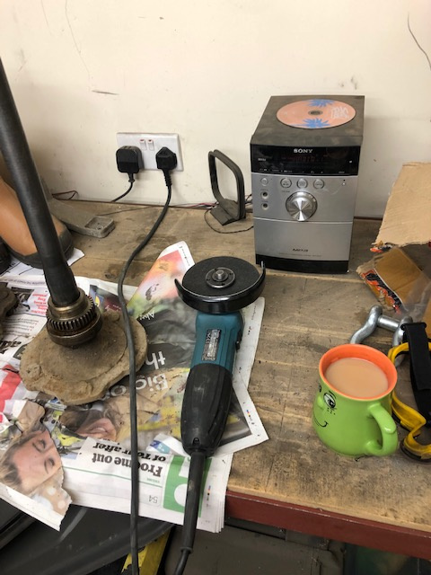

Kettle on, Mr. Angry out...
And cut the collars and bearings off!... ABS collars come tomorrow, combine them with the Koyo bearings from the BigJimny store and fit them and reassemble everything on Sunday then... Still in good time for our next planned trip, our annual traditional Christmas Run on the 29th...

I drew a tool,,,
Cut it out...

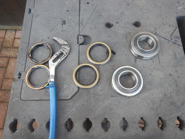

Oil seals out with my special tool...
Half a pair of over-centre pliers!
The new seals get tapped in with a front bearing tool as it's the right diameter
