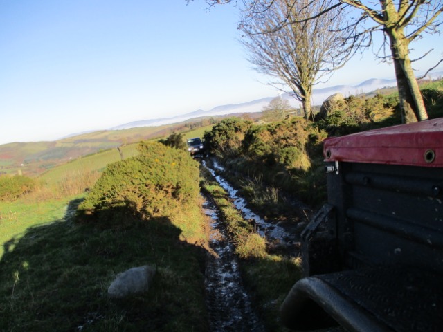

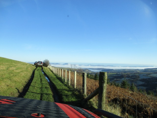

Replied by Riccy on topic Dave's "S200KYS" Jimny 'laner Build...
Thanks for the room for the night Dave! Very kind of you.
and such a shame your panhard mount was playing up
You missed some lovely views on the tops with cloud inversion:

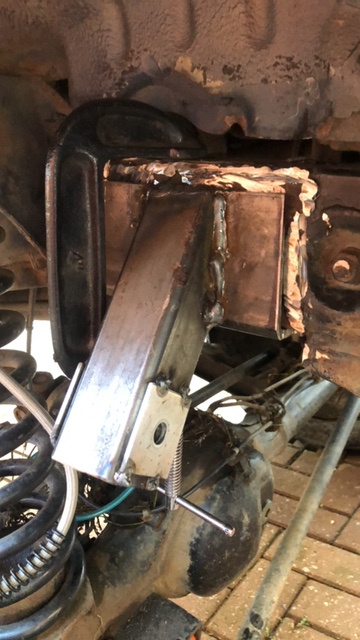

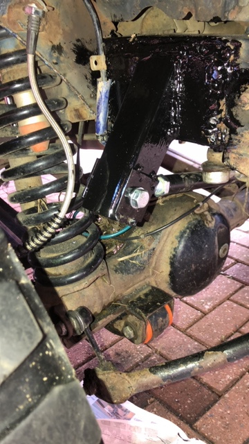

Repairs day today then...
I stripped the old panhard rod mount off, and found the 3mm stick steel of the 4"x2" box section I used back in July to make the repair had been torn in two just before the welds, so this time I used some 6"x4" box which is 6mm thick, and rather than try and rescue the old mount, I made a new one out of some 4"x2" box section that had already been cut in nalf length ways when I was making a batch of shock spacers...
On, painted, reassembled...
A few more little jobs to do, and one outstanding
There's a graunchin noise coming from the back near side... suspect it's the wheel bearing on the way out, so I'll pop the shaft out on Sunday for a look...
