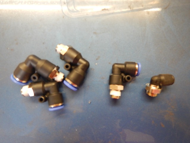

Due to a little welding accident (!) and the fact the rear breather elbow had snapped off as well...

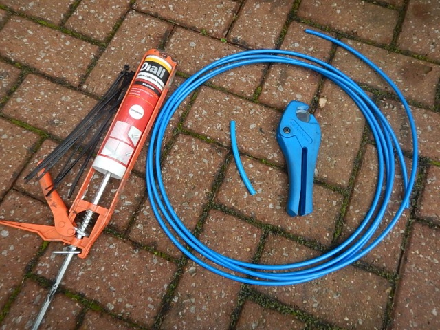

I'd ordered a few elbows for spares as well earlier in the week... on the right of the photo you can see an elbows the same as the one that snapped, and the rest are more substantial and a mix of fittings for both 6mm and 8mm tubes...
Add some replacement nylon tube, cutters and sealant and ty-wraps...

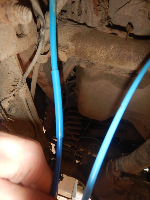

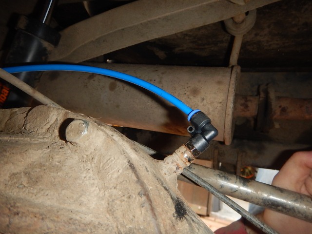

On the left.. the replacement tube to the rear breather elbow (the welding accident melted the original tube!), so you can just about make out the two 6mm OD 4mm ID tube (original and extension) with a 6mm ID 8 mm OD sleeve to connect them together, and on the right... a new tube I'd connected to the compressor and fed round the fuel tank...

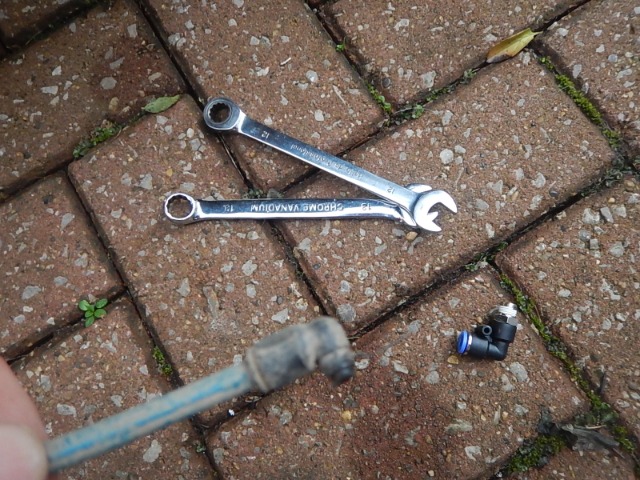

Snapped elbow, new elbow and spanners...

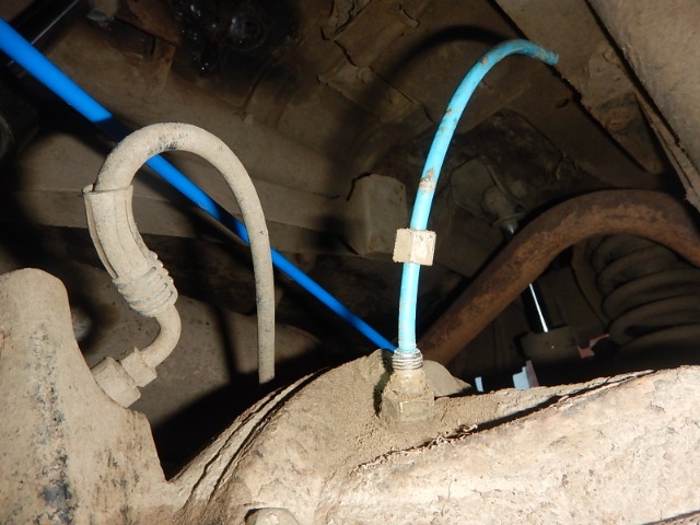

Hmmm, but I can't remember how the ARB compressor tube connects to the diff?! It was over five years ago!!! :lol:
A quick google...
Ah, ok...

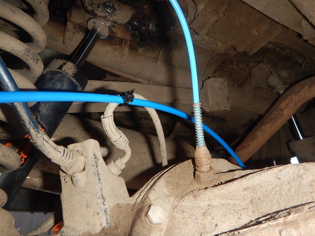

Disassembled, and new tube ready with the spring and nut over the new tube...
All in place and ty-wrapped neatly..
Tested, and the compressor now stops! Before it just ran and ran as the original supply tube had melted in the welding accident

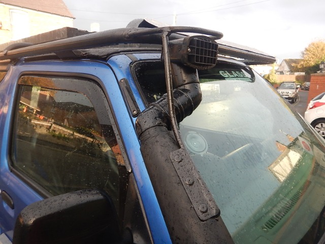

After loosing the snorkel head on the last 'lane of the day on the Lake District day trip...
The guard from the snorkel tube body up to the guard loop off the tree roof bars was replaced and riveted to the snorkel body..

New elbow with added extension tube from the sleeved join now in place... sorted!

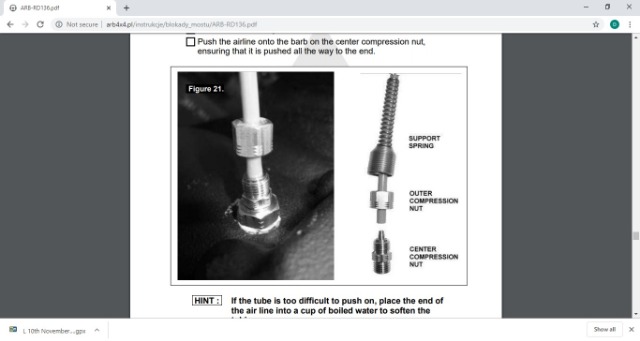

A quick google...
Ah, ok...
