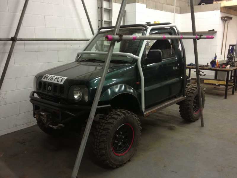

Vytrix wrote: It all depends how much u can do urself mate.
Nothing to be honest. Just interested how much if I were to hand over the J and said do the lot.

  • Vytrix
14 Mar 2013 20:48 #65704 by Vytrix
Replied by Vytrix on topic Re: My tray back
Say maybe 2000. Just body n cage, guestimate.

  • Dave cc
14 Mar 2013 21:52 #65711 by Dave cc
Replied by Dave cc on topic My tray back
Vytrix wrote: I like the sound of the bonding idea rather than welding, but I would bond it all together after you cut the back off as the centre of the cab is about 20-30mm wider than the rear end so you have to cut the frame in half and then weld the door on in the middle which leaves 10-15mm gaps either side which you need plate.
You are the man :) that is like the best bit of info you could have given me could save a whole lot of heart ache Owe you 1 for that :)
