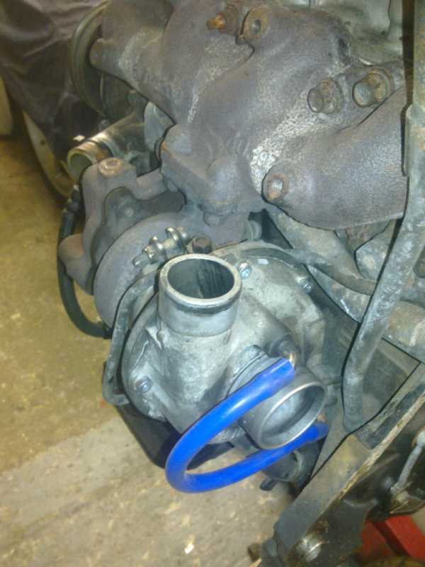

01 Mar 2013 22:32 - 01 Mar 2013 23:39 #64319 by Dave cc
Replied by Dave cc on topic Step by step Isuzu diesel conversion
Thanks Guys for your comment and also to Martin for putting it on the front page :)
Have turned turbo compressor housing and reffited manifold you will need to replace the dump valve acuator pipe as will not be long enough. Found a piece of blue silicon hose to reconect it and some M5 socket head cap screws to replace the god awfull Torx screws fitted on the IHI turbo housing. Whole job realistically took just over an hour to do luckily Isuzu use metal laminated gaskets that you can just re use them so the cost of doing this mod was virtually nothing :)
