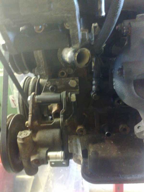

Apologies first for being a total slack Bast!!d on this post
Have had so much to do with designing an adaptor to doing M and G series gearbox but can see the light now
Other problem has been engine mounts my truck is so 1 off needed to make it all a bit simpler
Have now designed and made 1st off prototype to relocate the Isuzu alternator (that would also be jammed hard against the N/S chassis rail if not moved) up out of the way of mud and water and have dropped the power steering pump into its place
This also allows the access to the side of the engine to pick up in the correct place (you can see the 3 free holes in the photo)on the block and not end up with some heath Robinson set up as I have seen done.
Always pleased to hear your comments and criticisms beleive you me working it all out sounds alot easier than it it is

03 Aug 2013 19:41 #78876
by page
Replied by page on topic Step by step Isuzu diesel conversion
Looking good Dave this will be handy for me doing mine

- Dave cc
03 Aug 2013 20:20 #78881
by Dave cc
Yeah its because of yours and the others lol needed to get this bit sorted properly only problem is its better than mine now :laugh: :laugh: :laugh:
Replied by Dave cc on topic Step by step Isuzu diesel conversion
page wrote: Looking good Dave this will be handy for me doing mine
