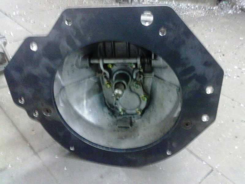

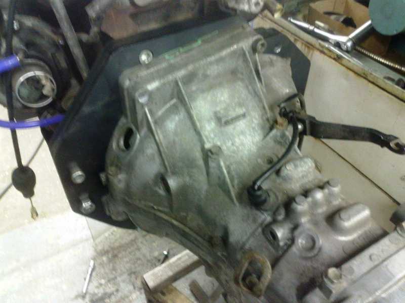

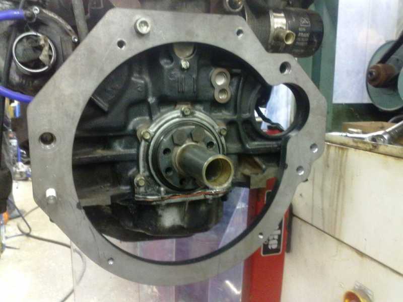

Few more pictures to show
Engine adaptor in place
Gearbox adaptor in place
Gearbox on to engine yes and before you say its a SJ gearbox same fitment as a G series Jimny box
Forgot to say ive got a few kits to be made up ;)

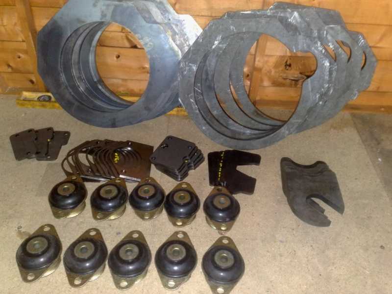

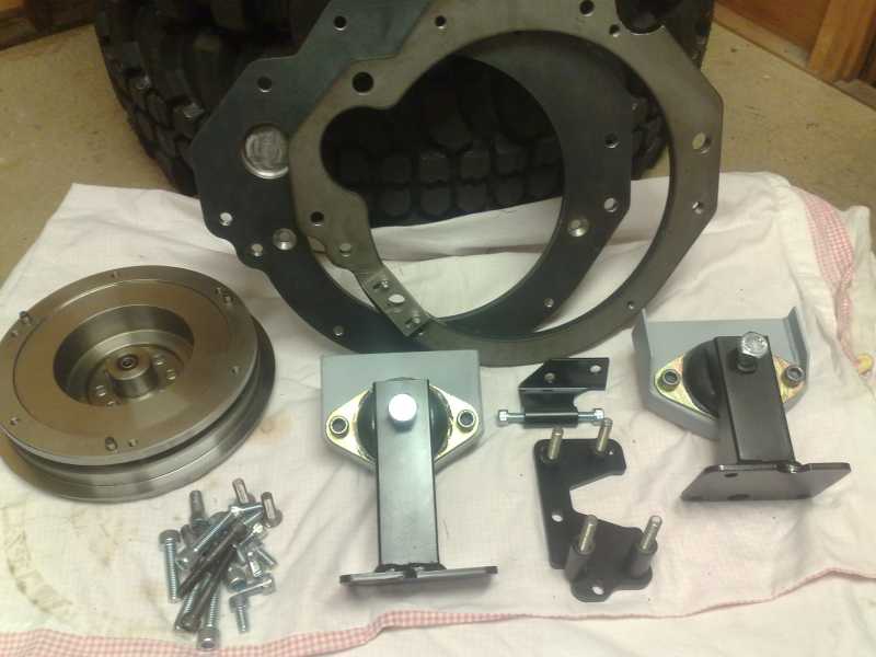

  • Dave cc
01 Oct 2013 18:30 #84911 by Dave cc
Replied by Dave cc on topic Re:Step by step Isuzu diesel conversion
Here you go girls and boys i know its a fair bit of money for the kit but damn cheaper than some and you get a lot of stuff for your hard earned coin
