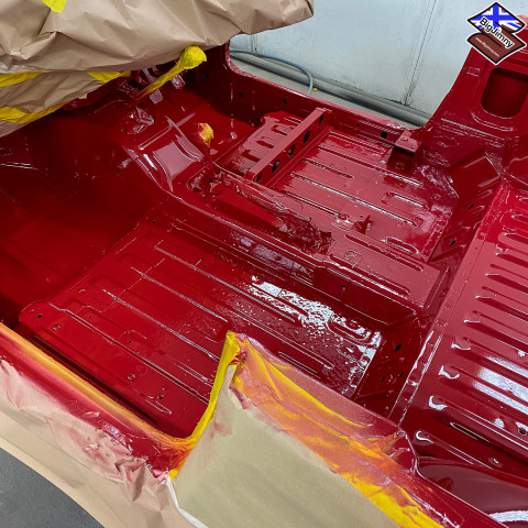

Inside the car, seam sealant has been applied to the newly welded seams and on the floor sections where repairs have been carried out replacement sound deadening has been applied (the black stuff)
As not all of the sound deadening had been removed only replacement cutouts were needed to replace the missing parts.
With the final seam sealant and sound deadening in place the SJ has then been masked up for the inside to be painted,
So here is the first proper view of the smart new paint.
On the left is the front foot and seat area where the sound deadening is. This means the paint is not 100% smooth which is, of course, normal for an SJ.
