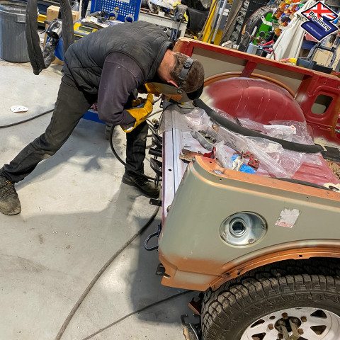

First, at the rear, the fuel filler is fitted. This has to be braised into position rather than traditional welding. This is the same as they do in the factory.
Then Winchfield Engineering moved onto the wheel arches. In the factory the SJ is assembled using spot welding therefore, for a proper restoration, the new panels also should be welded in place. This is because a proper spot weld has a classic look to it which a MIG seam weld or MIG Spot weld emulation just doesnt have.
So the wheel arch supports are spot welded into place.
