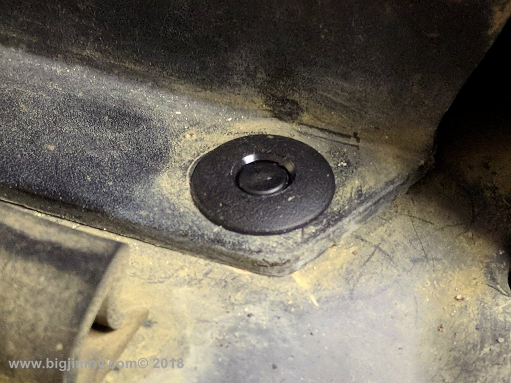

Centre Dot Fasteners
Jimny_IMG_20180108_123617
Not really a how-to, more a rant on the mis-use of these fasteners!
I have had my Jimny for 10 years so it was owned by others for 4-5 years before that. Up to now I have been giving it a hard time off-roading it so I have not been too concerned about the finer details of how it looked. However...
