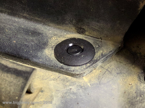

Typically, the first thing you want to do is remove the old fastener, the picture below shows one in place and you can see the "dot" flush with the top of the fastener.
Now, to remove this you do not try and prise the button up or prise the whole fastener out. Instead you use a fine point device to push the little centre button IN, it will click inwards with mild pressure. Here you can see me doing it with a fine bladed screw driver.
When you have done this the whole fastener will easily lift out.
