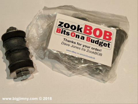

So as part of my rebuild it is time to replace them and try and reduce the cabin noise. Dave over at zookbob (www.zookbob.com) or his Ebay store sells a nice set of rubber based heavy duty mounts. In the third picture you can see one alongside the older heavy duty bush.
There is not a lot to say about fitting them. I simply unbolted the old ones and then inserted the new large bushes and bolted the whole lot together. However, it was difficult to get the nut started on the thread as the rubber was uncompressed. I simply used a G-clamp to apply a small bit of compression so the nut would start on the thread cleanly.
As you can see, the mount is fitted with the two large bushes forming the core onto which the transfer box metal mounting arm rests. The nut, bolt, washers and thin rubber mount then form the outer sandwich to bolt the whole assembly together.
