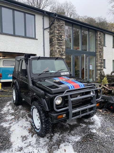

17 Nov 2023 17:53 #252176 by lesgrandepotato
I’ll just leave this here….

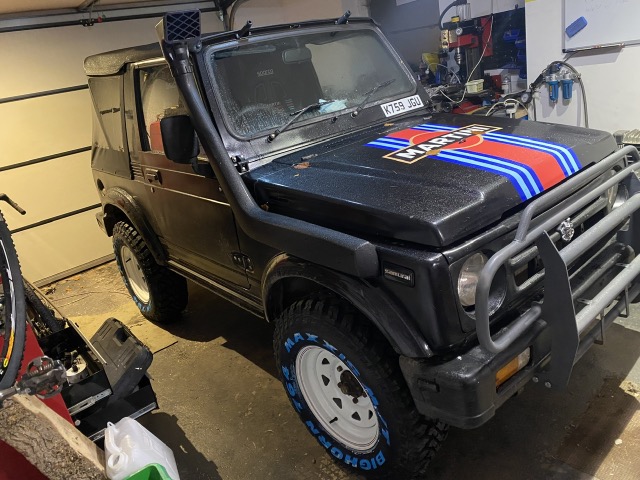

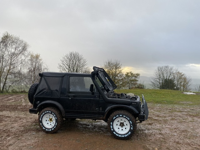

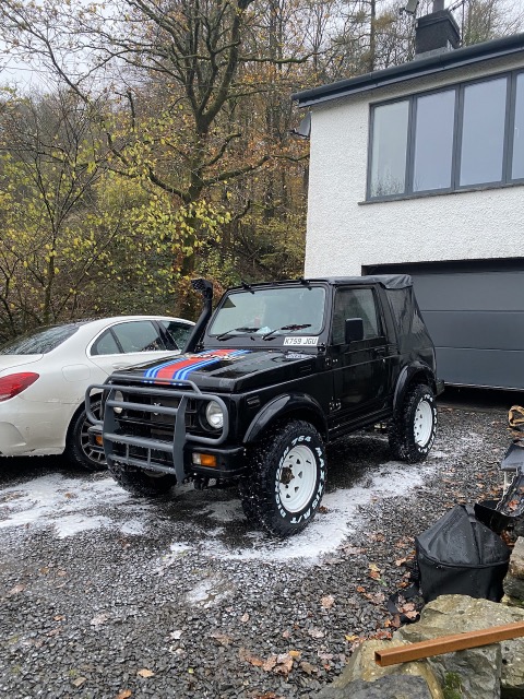

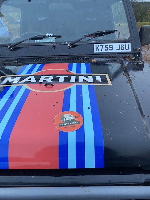

18 Nov 2023 15:28 #252199 by lesgrandepotato
    Wheels all fitted up. Minor trimming required, but have tried to keep to the ‘stock plus’ vibe.
235/75 r15s on 7in rims with zero offset.
I think I’ve nailed the look I was after :-)
The following user(s) said Thank You: mlines, yakuza
19 Nov 2023 17:36 #252224 by lesgrandepotato
First trial on the new tyres today.. a slimy Edenhall with North lakes 4x4.Didn’t start well as driver 1 and clattered the cane on the 10 gate. Over the day I started to gel a bit more with the car and pretty much anything left on the score sheet was down to driver error / exuberance.Fine day out and I’m pretty pleased with the Maxxis boots and the SJ’s motorway performance. Few niggles for next season to sort with a speedo failure and not charging at high RPM.. that and a full service / inspection and we are good for the next year.
