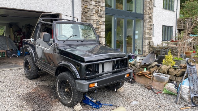

Cut the tail mount out in many many pieces and freed the floor. Once that was out the shell went some what lozenge shaped.
With the promise of beer and bbq I got the boys over to chuck the shell back on the chassis.
I could then turn my attention to the inner cross member and getting the back aligned.
The shell was pretty easy to move around with a ratchet strap to get the tail gate sitting well. Then spotted and fully welded in.
Next job was test fitting the wings. Well they kinda fit…. More on this in the week. Think Martin got off easy with just one spot weld to break.
I’ve got the bonnet on for alignment and the door. Both wings are cock eyed in different ways and the top and bottom rails for the grill are just garbage.
Still a few evenings tapping will get that sorted…
She’s sitting pretty well tho on the new OME suspension, nothing too crazy but should be a bit more capable than the stock jimmy we’ve been using for competition.
Taking inspiration from the somewhat wild 1980’s graphics these seem to wear… a graphics package has been ordered!

14 May 2023 19:41 #249108
by lesgrandepotato
Replied by lesgrandepotato on topic New SJ owner - couple of q’s
I think I’m probably going to split all the spots round the headlight rim. One is 10mm further set back than the other one…. I think loosening it all up and pulling it back to shape is the way forward.
Popped the hood on and the doors. Damn it looks good. Can’t wait to get it into paint and graphics. Then see if it’s any good in the muck

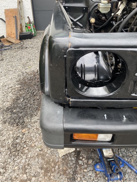

16 May 2023 06:30 #249129
by lesgrandepotato
Popped the spots at on the passenger side wing last night. It’s pulled in nicely.
The drivers side is getting closer. Think I’m going to have to re-drill where the grill pins pop in. It’s a right old fiddle.
I’ve got pattern parts for the grill bars top and bottom. They are absolutely shockingly bad.
I need to make a choice between them and the rusted originals with all lots of sheared off bolts.
In the favour of the re-pops none of the threads are any where close so I could just put them in the right places….

16 May 2023 19:23 #249144
by lesgrandepotato
Hmmm hmmm hmm so now the grill fits in the hole. However… the head light bowls are substantially offset from the grill holes. This might be because it’s rhd. But I suspect it’s because the brackets are in the wrong place.
Are all after market wings garbage?
