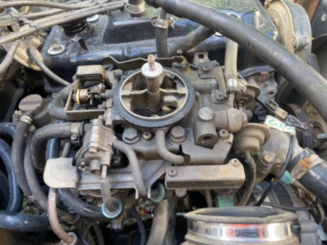

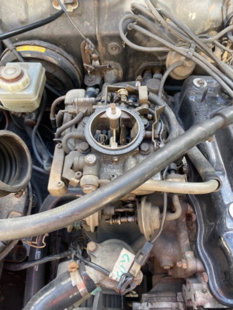

Failed at the first hurdle! Well the incline at the end of the drive…
So it seems that we have a running under load issue. It idles well, the accelerator pump jets are good.
But if you rev it up then it goes up with the (pump jets) then falls away. So I guess we aren’t transitioning to the secondary or main jets….
It’s a pretty complex looking beast the carb. Does a service / test manual / procedure exist?
When I rev it looking down the barrels then I don’t see the secondary move? Would that be expected? It’s not under load but it’s hitting 5k rpm so I kinda thought it would pull open?

So I’ve pulled the carb. I’ll need a rebuild kit. It looks somewhat complex. But that’s just a bunch of simple stuff nailed together.
Where are we going for a decent Aisin 83020 kit?

Pulled the carb apart. Replaced 14! Vac hoses and blew it out with compressed air. That’s got it running better. Spent some time setting the timing and then tried to get a decent idle. It’s getting better. Idle mix was way off and it’s less hunting than it was.
