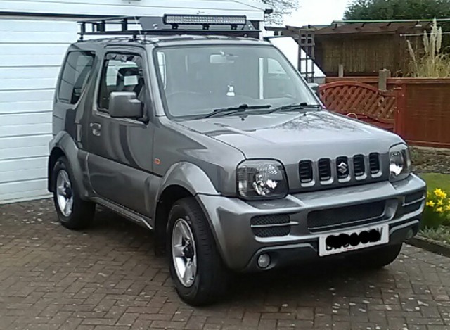

Time to introduce our Jimny which we have owned for over 2 years now. We always wanted one, but the low unbraked towing limit kept us away until I eventually reduced the weight of our caravan. It's our daily transport and so spends 90% of its life on the queen's highway, only occasionally venturing off road, but even then nothing it can't cope with in it's standard form.
I have made some modifications and improvements over the two years, so this may be interesting for those that have similar requirements.
Say hello to our Jimny
I added the Jimnybits roof rack first as we carry a lot of camping equipment, it's just easier to throw damp items on the roof. It's a well made item but the powder coating started to show signs of rust after a year, but I sprayed it myself before it took hold which has stopped it totally. It did increase wind noise slightly, but made no noticeable difference to mpg.

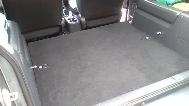

Next to go was the rear seats, we simply needed to space and have no need to carry more than two people. I used a plywood base and covered with black automotive carpet to keep the noise down.

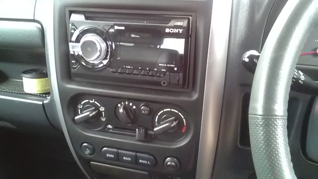

The original Clarion sound system was "vintage" in every way, so streaming from my phone and all that modern MP3 stuff was added courtesy of Sony and a new fascia. I worked at Halfords at the time so it was very cheap to do with my colleague discount. Also added rear speakers and new fronts to compliment the better sound system.

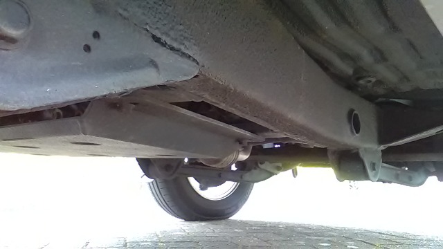

Next was the surface rust and transfer box wires. When you are under the vehicle treating rust it becomes apparent that the transfer box cables are going to be the first victim of even mild off road adventures, so as JimnyBits are 5 miles from my home it was rude not to fit their transfer guard. At the same time I treated any rust and painted, finally applying black waxoyl. It's been on for 1.5 years but still looking fine.

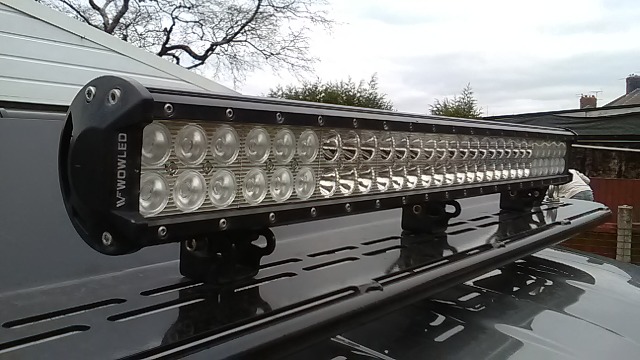

The led Light bar was added to assist with those late night arrivals at the camp site. I did not expect it to last electrically, cosmetically or remain watertight. It's proven me wrong, 1 year later it still works, still looks like new and has not filled with water. Not everything on eBay is rubbish, a big thumbs up to WOWLED. It's 180W and very bright and an easy fit to the roof rack. The power cable is routed though the aerial mount to an illuminated switch on the dashboard. Works great as a route for the cable, but if you like FM radio it does pick up the led switching noise, so that the down side.

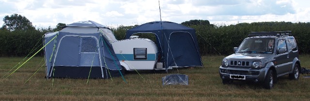

I had a vintage (very old) CI Sprite 4 berth which served us proud during our "parenting" years, but now it's only me and the better half we wanted smaller car and everything else. So I reduced the weight by swapping it for a Teardrop "caravan"
It's 350kg unladen and basically a very comfortable sleeping compartment (sleeps 2) with a kitchen on the back. The tent covers the kitchen and provides a sitting area. It's got electric, TV, central heating (including the tent) and our Jimny can tow it all no problem. I guess we are adding 600kg to the vehicle AUW with the stuff we carry, with about 360kg of this on the tow bar.
So it's comfortable and warm camping!
Here is camp Jimny all set up, you can see the caravan sleeper in-between the tents.
If you want to know more about it pm me and I will send details.
