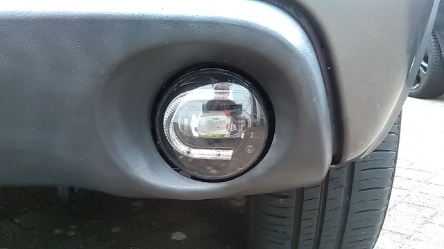

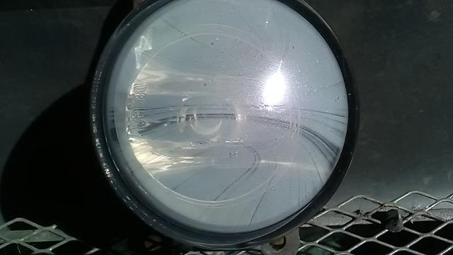

So today I replaced the fog lights that had ironically gone foggy !
As my Jimny is mainly fighting for space on urban roads I wanted to fit Daylight Running Lights (DRL) to assist other road users to spot me, so I obtained a set of combined DRL and Fogs to do both.
The DRL Fogs came via Car Mod Shop LTD in Sidmouth, a quick email confirmed they would fit the Jimny, which they did!
Old foggy fog lights

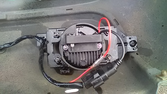

The new combined DRL and Fog actually fitted the Jimny holder with a minor modification. I had to remove the old fog idiot tab (prevents installation upside down), I cut it off, but once remove the new went straight in the holder. The fitted plug on the DRL (fog) is a direct fit into the Suzuki loom, you just need to get the marked polarity the correct way around. Black is earth, coloured cable is fog supply. The supplied extras single cable for the DRL light was integrated into the front loom, so it's all nice and tidy.
I've not connected the DRL element at this time, but I plan to use a single changeover relay with the normally close contact fed from the heater fuse. I believe this an IGN2 function, ie it is only active when the car ignition is in the position for running, but not connected during starting, when off, or in Aux postion. This will be the feed to the DRL light, but I'll check my assumption before I connect it. The coil of the relay will tap into the side light, so when the lights are on the relay will energise and disconnect the DRL feed.
The cheap DRL controller I had purchased would not function with my combination Fog /DRL as it is switching the negative feed, but it's something you can only determine once purchased, as no instructions are provided. It was cheap enough to be gutted for the waterproof connectors, so it has its use.
New Fog / DRL installed. Just waiting for it to go darker so I can adjust the beam position.
