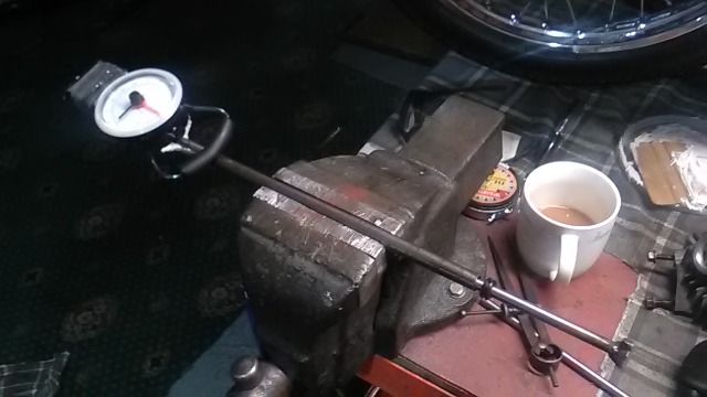

Having just changed the PAS and Alternator drive belts I noted the manual is quite specific about the required tension. It quotes a mm deflection range at a force of 10kg, something you just can't achieve without a special tool of some sort.
So I got bored and made one using the luggage scales (won't need it for some time) and some scrap steel tube and bar I had in the workshop.
You simply push down on the belt until the required 10kg load, the grommet on the shaft records the deflection, simple.
Yes I could have used the twist belt method or just done it up tight, but these don't satisfy my slight OCD and the need to know it's within spec. I can sleep again tonight. :laugh:

D'oh !
No one spotted the mistake?
The rubber grommet is not a measure of belt deflection, it's just another measurement of load applied. Luckily my brain kicked in before I used it to tighten the belts. Still works well enough to apply the correct load, but you need two high visable marks on a suitable stick at the side of the belt to see the deflection.
It surprised me how tight the belts actually are compared to the old style fan belts of yesteryear. Being old and not use to this "modern stuff", my calibrated thumb would have never gone tight enough.
Mike
Mike
